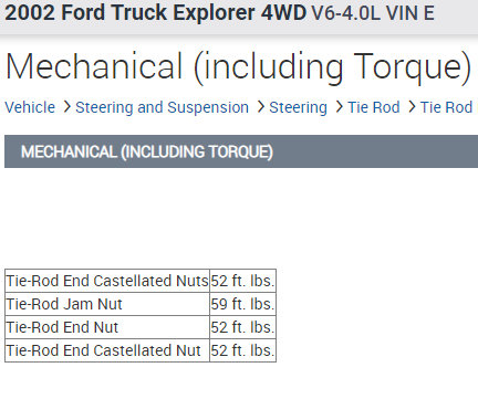

You will need few specific tools to replace the tie rods.
Please refer to this article for some good information:
https://www.2carpros.com/articles/tie-rod-end-replacement
Also see attached for the torque specifications.
Let me know if you have any questions.
