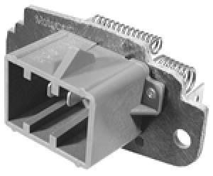

I have changed the blower control switch but it will only operate on high.

Blower motor resistor, find yours and change it, it should be near yhe blower motor,(more than likely connected to the blower motor housing.
this is what you are looking for
