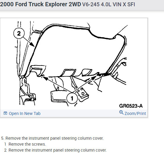

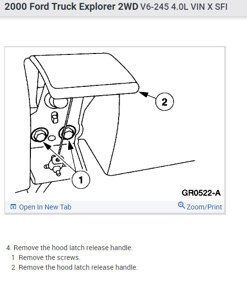

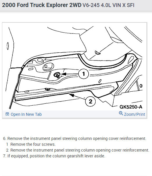

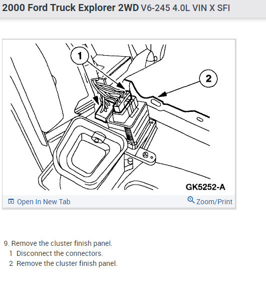

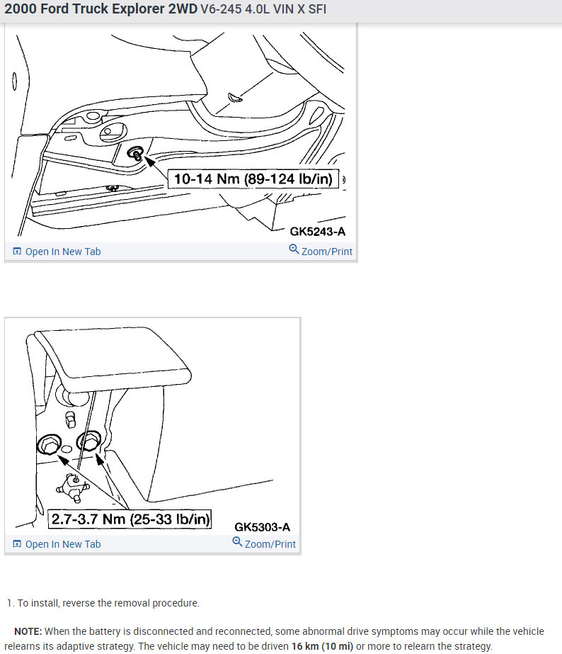

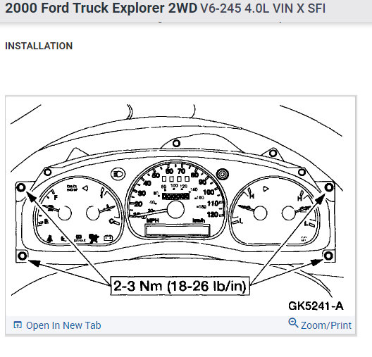

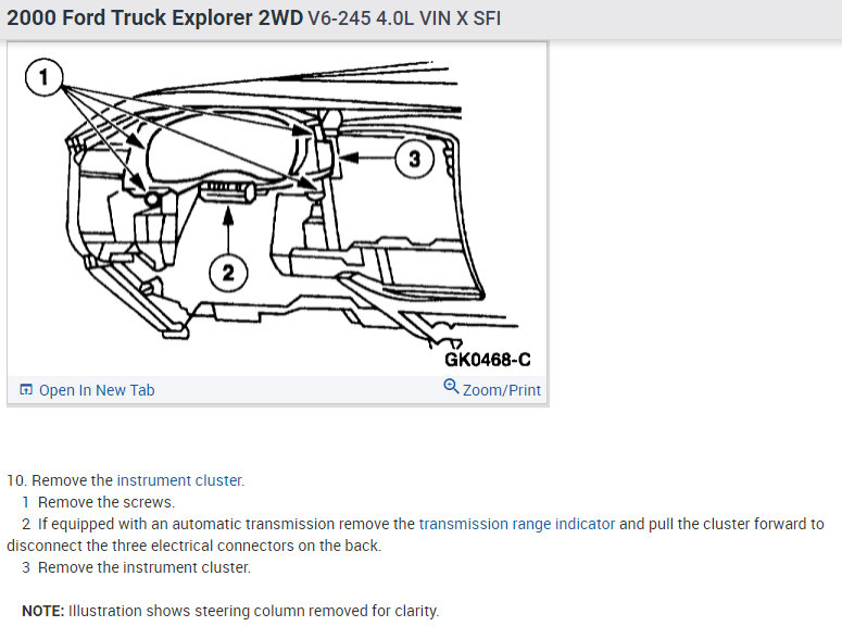

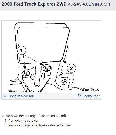

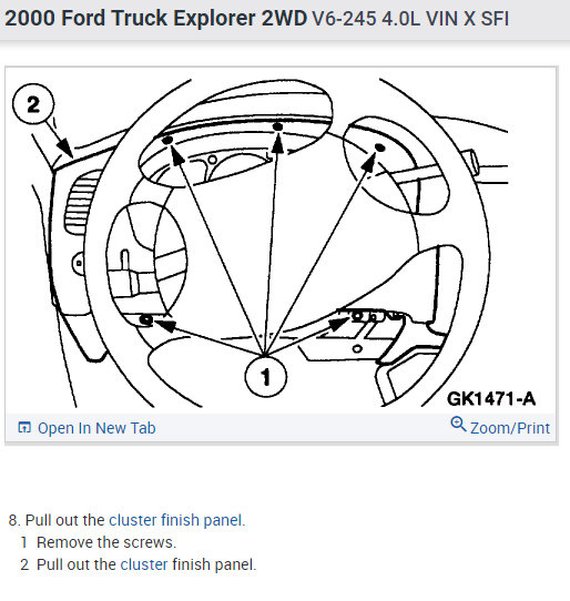

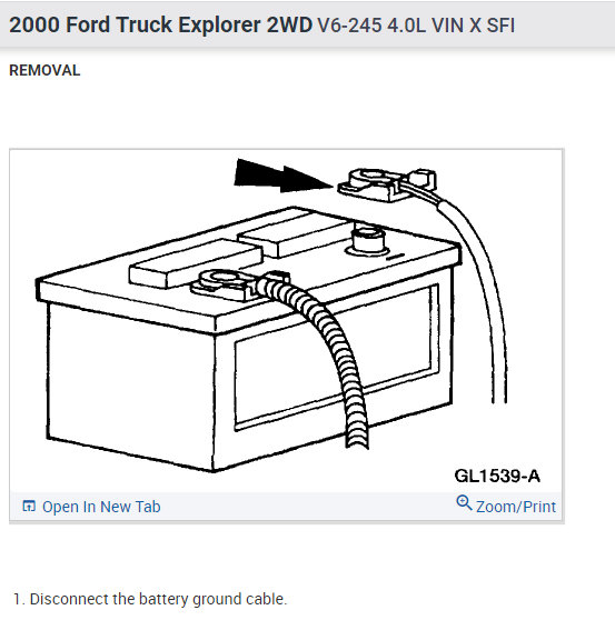

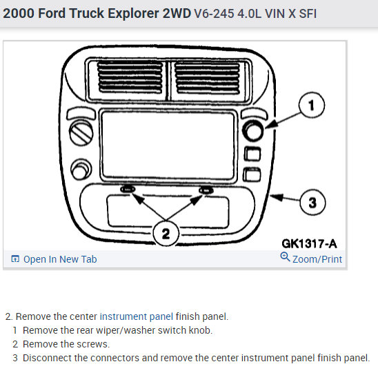

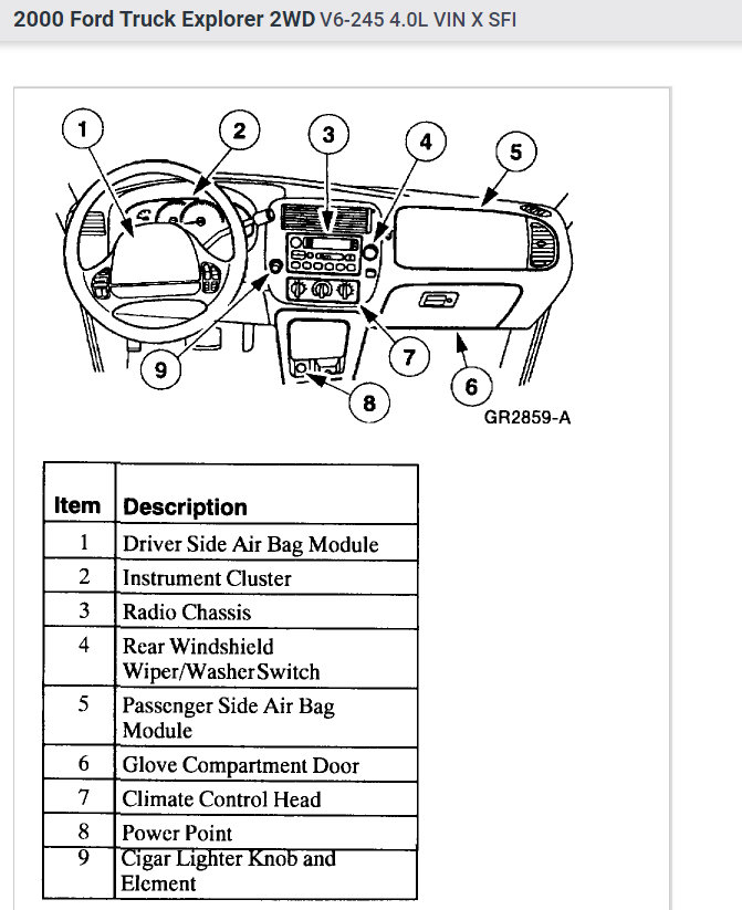

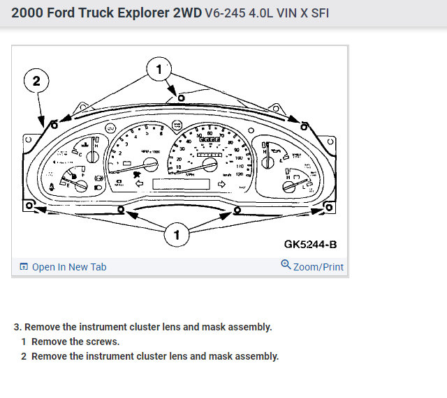

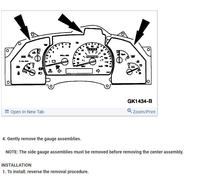

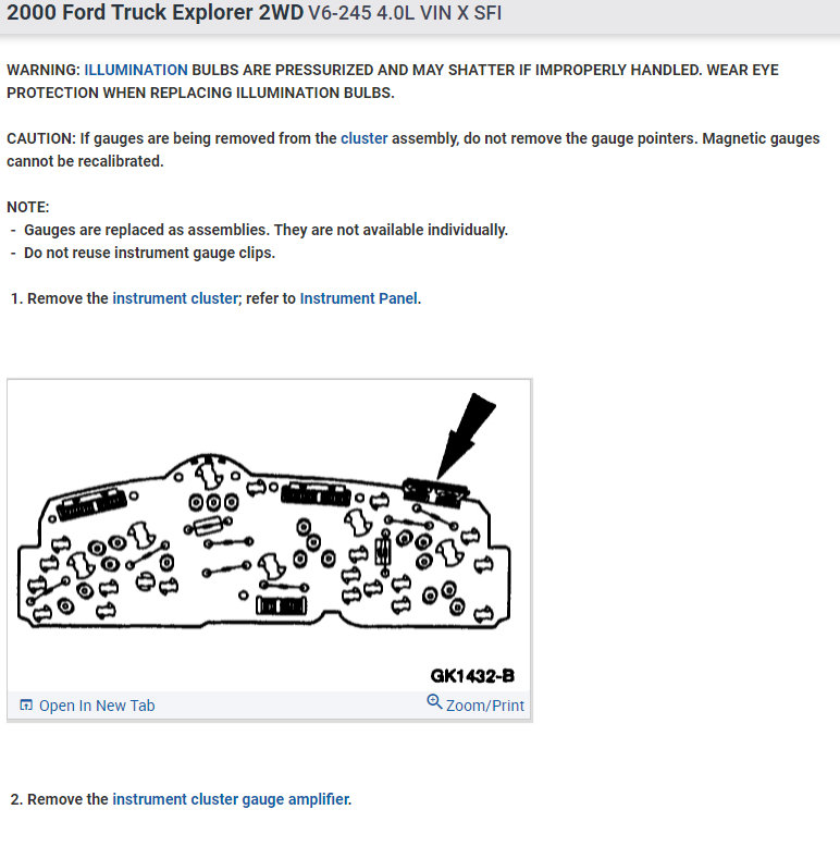

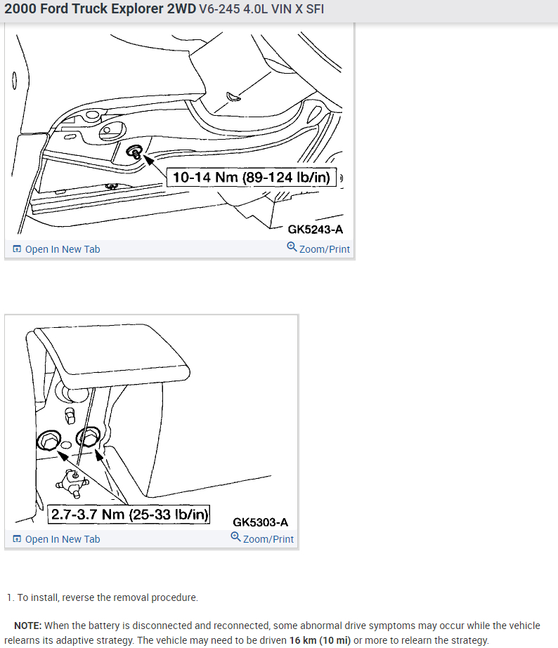

The light behind the gauges is out, how do I remove the plastic instrument cover that covers the instrument cluster?
Friday, January 23rd, 2009 AT 8:52 PM
SQM
MECHANIC
6,383 POSTS
In order to remove the instrument cluster, you will have to remove all the the plastic trim around the dash. It can be done with simple hand tools.
Here is a video guide of how to access the cluster:
https://youtu.be/_HEC44xENxw
I have attached (see below) the complete process of how to access the instrument cluster on your vehicle.
