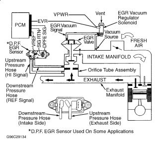

Engine is missing realy bad. Random cyclinder misfire, bank I lean, bank 2 lean. Changed M.A.F. Cencor, Map cencor, EGR cencor Idler control valve, plugs and wires. I'm getting a code that no one knows 1401. Please help.

DPF EGR Sensor Circuit High Voltage detected. see figure

I have already changed that part and it didnt make any difference. Anymore ideas?

Have you checked fuel pressure? Did you have code P0300?

I havn't checked the fuel presure. Would it be fuel pump or some kind of sencor? I don't remember any such code.

Did you check hoses to DPE for leaks, cracking? Also possible blockage of ports where hoses connect
