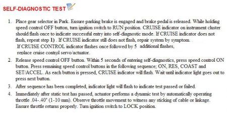

Cruise does not come on any more, have checked all mini fuses and like fuses, have not checked relays. What needs fixed to make it come on and work again? Thanks

Does the CC indicator light come on at all when switch is engaged? How about the brake lights, are they still working fine?

No cc light on, brake lights work

Perform diagnostic test on the CC system by following steps below. let me know what code/s you retrieve, if any.

Goes into self diagnostics - after pressing "ON" light comes on then goes out- but resume does not make light come on, nor does coast or set/ accel

Have to be certain you are pressing ON within 5 seconds of entering the diagnostic

Does run through on-resume-coast-set/accel, have not yet gotten visual confirmation that cable moves, dont know if im getting out of vehicle fast enough

You can just watch the gas pedal, no need to go under hood and watch

Went through diagnostics, light flashes twice, break pedal does not move

Okay, this indicates a fault with the brake pedal position switch, most likely the switch itself is faulty but first ensure that the wiring is connected properly and not damaged. The BPP switch is located on the brake pedal support, above brake pedal.

Put new switch in, ran diagnostic test cant tell if gas pedal moved, all other lights flash. Havent driven it yet to try speed control. Reverse quit working, snow causing problems pushing it out of driveway.
