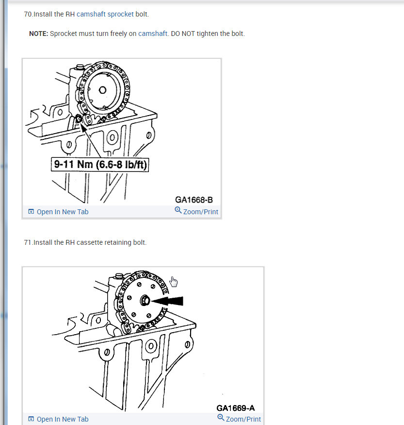

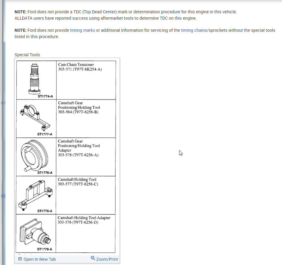

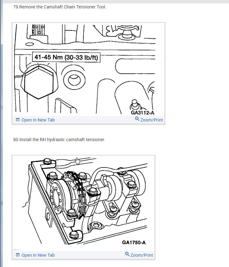

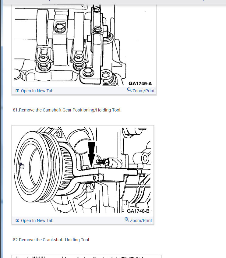

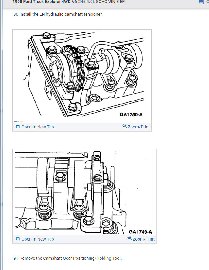

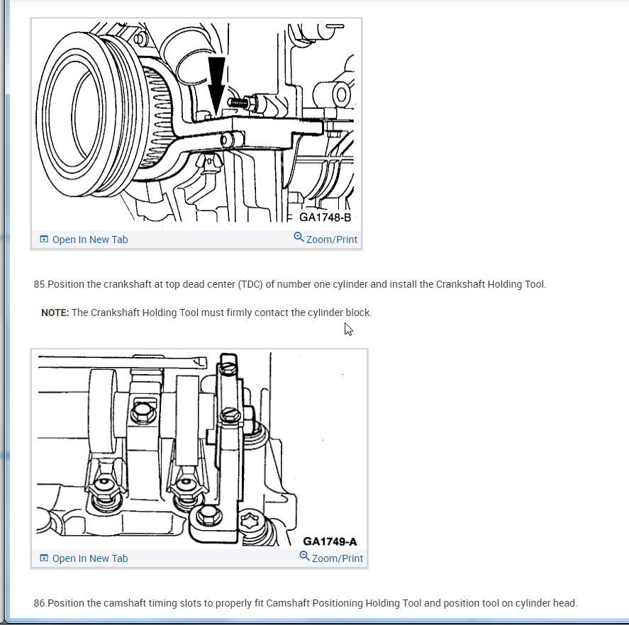

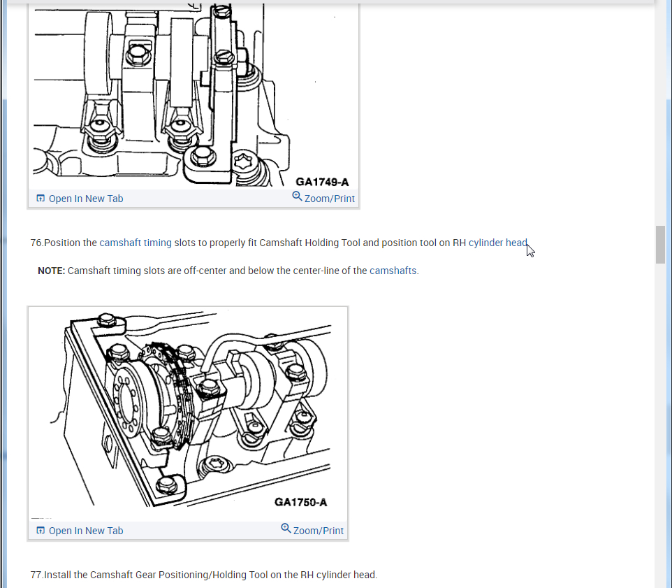

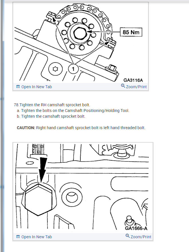

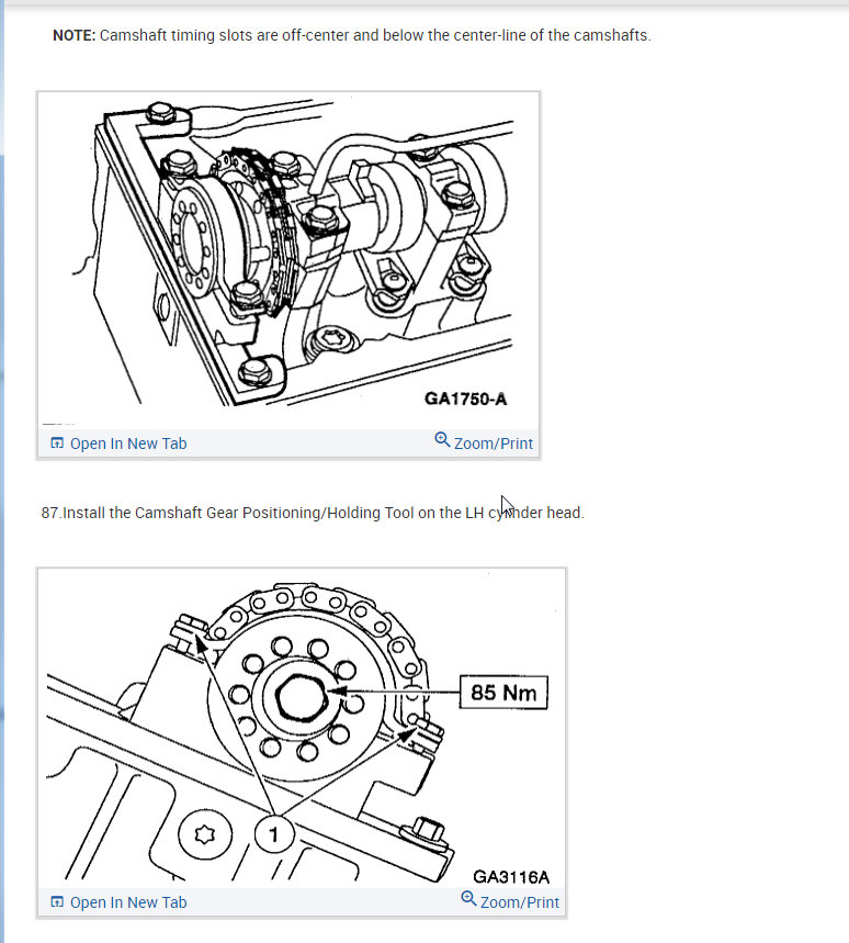

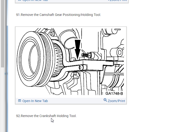

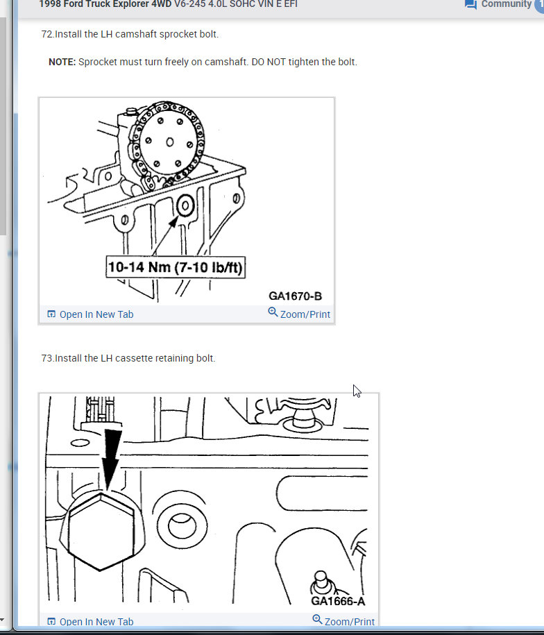

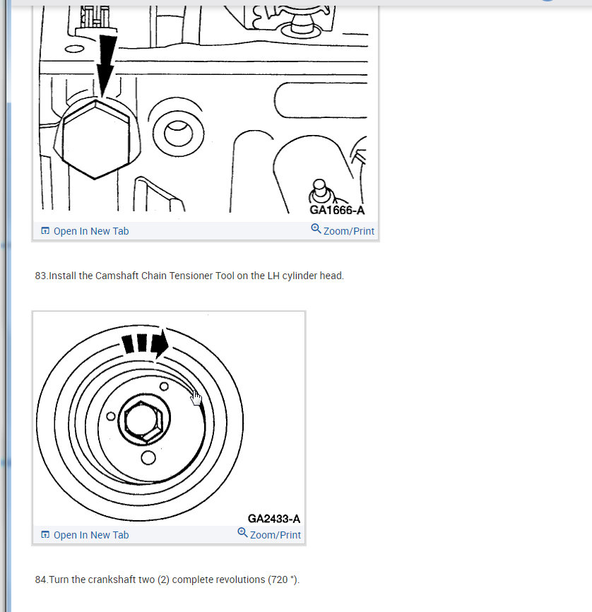

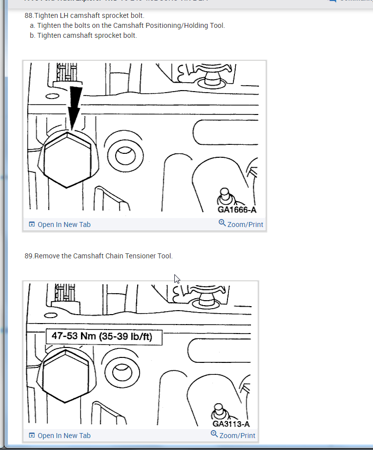

Having a hard time adjusting the timing chain on the passenger side, to fit the sprocket.

I am attaching the procedure for setting up the timing. Take a look at this and let us know what other info you need.
Let us know if you have other questions or what happens with this process. Thanks
