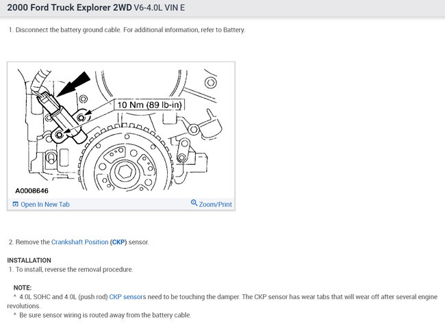

I'm looking to replace the crank positioning sensor as well as the Idle Air Control Valve on our Ford Explorer. For the most part, the Idle control looks fairly simple to replace. Is there anything technical I should know about replacing this other than plug and go?
Also. Where exactly is the Crank Sensor located. I haven't even looked for this, but I was told that this is one of the reasons for our idling issues.

Crankshaft sensor is centered in lower front of engine compartment you may have to loosen Ac comp so you can pull it out. Check out the diagrams (Below). Please let us know if you need anything else to get the problem fixed.

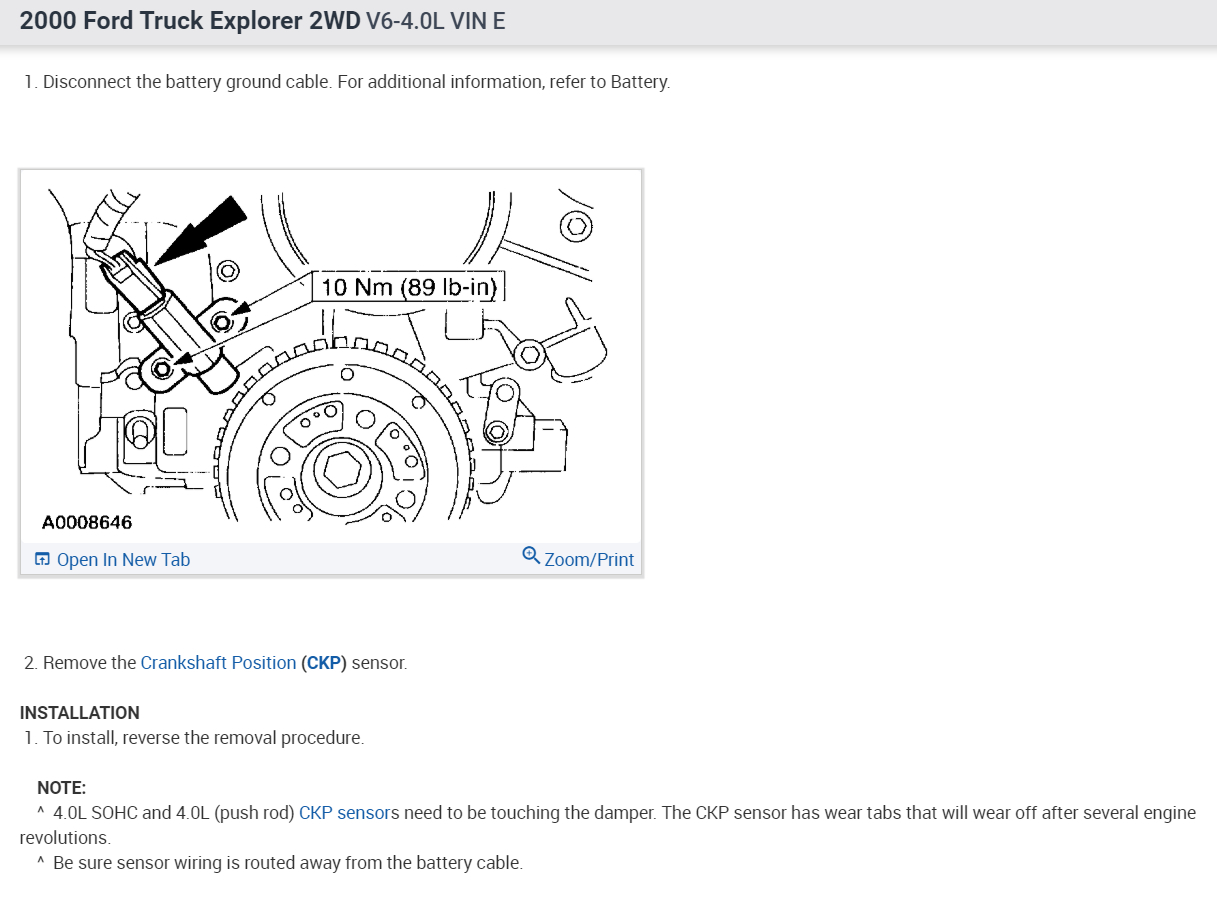

How to install crankshaft sensor?
Sunday, May 24th, 2020 AT 2:45 PM (Merged)
  • 108,355 POSTS
Here is a picture of the sensor and the directions for replacing it:
https://www.2carpros.com/forum/automotive_pictures/249084_1_2.jpg
Disconnect the negative battery cable.
To remove the CKP sensor, first disconnect the wire harness plug ...
Disengage the wiring harness connector from the
CKP sensor.
Loosen the CKP sensor mounting stud/bolts, then separate the sensor form the engine front cover.
Unbolt the sensor and pull it away from the engine-crankshaft damper removed for clarity
To install:
When installing a new sensor on the 4.0L (VIN X and E), position the sensor against the crankshaft damper. There are small rub tabs which wear off and allow the sensor to be perfectly spaced from the damper.
Position the sensor against the engine front cover, then install the mounting stud/bolts. Tighten them until snug.
Install the CKP sensor cover and retaining nuts; tighten the nuts until snug.
Reattach the wiring harness connector to the CKP sensor.
Connect the negative battery cable.
