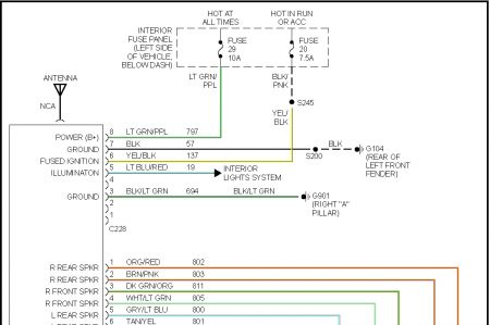

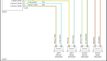

I am trying to put a cd player in my explorer an I really dont have the money for a wiring harness, so im trying to find out the color code

Sunday, October 3rd, 2010 AT 7:50 PM
