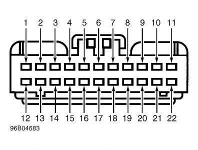

RACEFAN966
  • 5,029 POSTS
Sorry my bad the GEM controls it and it is in the center of the dash but we do not need to dig for that yet. First check fuse number 5 should be a 30 amp make sure it isn't blown. I am including a pic of the connector on the GEM module if the fuse is good then we will need to find the module and do some tests with a multi meter to see if it is telling the front to lock in. So this will be used for the next few test ok.

WCR-63
Hi! Ok, I got the relays finally back in place, I checked the #5 fuse, it was good, and I checked every other fuse to do with 4x4, every one looked good, should I mention that the truck had the emergency shoes and cables replaced for safety test? [Wheel sensors?] And that they never adj. The e-brakes very well as they won't hold the truck from rolling, also I removed the radio as it wasn't working properly so I have the opening ready to check the gem module, could it be something as simple as changing t/c fluid? Thanks eh wayne
