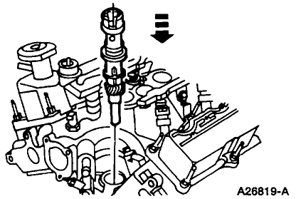

I heard a belt noise coming from under the hood, I took it to FORD, they said that I needed a new Serpentine belt, and a pulley tensioner because it was broken and cocking my belt to the side. I changed both, and the noise continued. I changed the altenator because the pulley on that was making a clicking noise, but the noise is still happening?

I think your problem may not be coming from the belt at all. This noise is commonly misdiagnosed as a belt noise when in reality the noise is coming from the Cam Sensor synchronizer. That is the drive mechanism that the Cam sensor is mounted on and it's located where the distributor normally would be. You can use a long screwdriver to your ear and the base of the drive to listen for the noise.
DO NOT remove or move that sensor without marking everything very carefully. This has to timed and requires a special tool to do this.

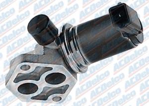

My truck just started to make this high pitch noise under the hood and noticed when I press on the gas more then when I let up also its cut off on me a couple of times when I come to a stop and when I put it in park the engine seems to reev some. What could it be.
Saturday, May 30th, 2020 AT 11:36 AM (Merged)
MERLIN2021
  • 17,250 POSTS
More than likley it's the idle air control valve, bolted to the side of the throttle body.
