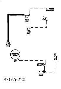

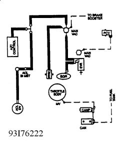

I have a 93 Ford Explorer 4.0L pushrod engine and I have been doing tune up work to it and I need a vacuum distribution diagram because one of the lines is not connected and I cant figure out where i went wrong putting it all back together. I have looked around the internet but no luck and the Haynes Manual for this truck does not show the diagram or even a good picture. Please help

Check under hood tag , it should be on it
https://images.2carpros.com/forum/automotive_pictures/99387_Graphic1_235.jpg
https://images.2carpros.com/forum/automotive_pictures/99387_Graphic2_112.jpg
https://images.2carpros.com/forum/automotive_pictures/99387_Graphic3_53.jpg
this is what I have hope it helps
