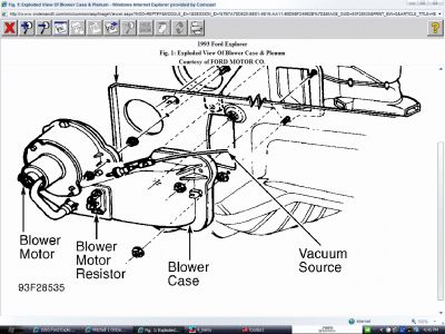

trying to find the heater blower motor resistor on my ford my hayes book tells me its on the firewall but i dont see it,the pictures they show don't show me what the one on my firewall looks like,the only thing that looks like the one they do show is on the housing to the heatercore any help would be nice thanks

It's on the a/c plenum right below and to the right of the motor...
https://images.2carpros.com/forum/automotive_pictures/62217_BMResistor_1.jpg
