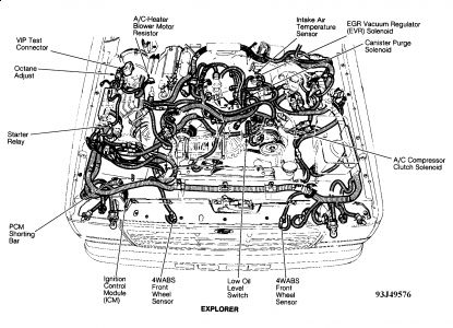

where is this resistor? That causes the fan to only blow on high?

It could be the relay too.
The relay is on the right inner fender in the power distribution box.
The resister is under the hood near the blower motor. Here is a picture. I hope you can blow it up to read it.
Let me know if this helps.
