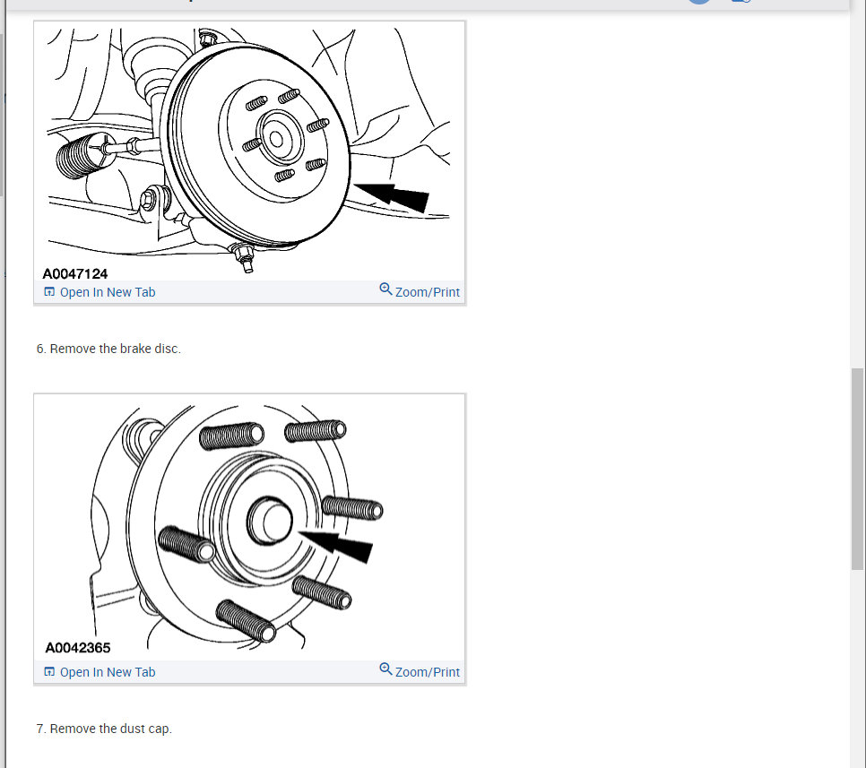

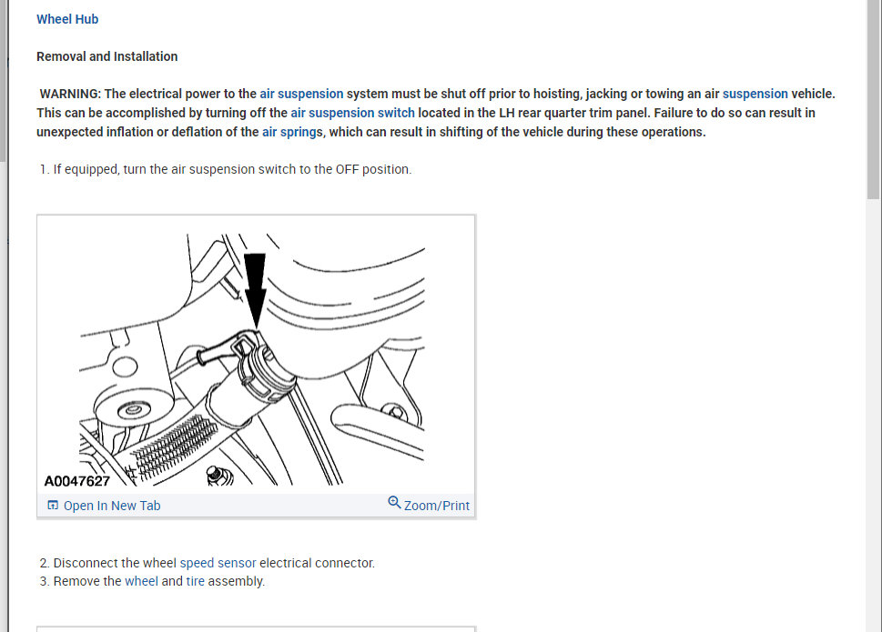

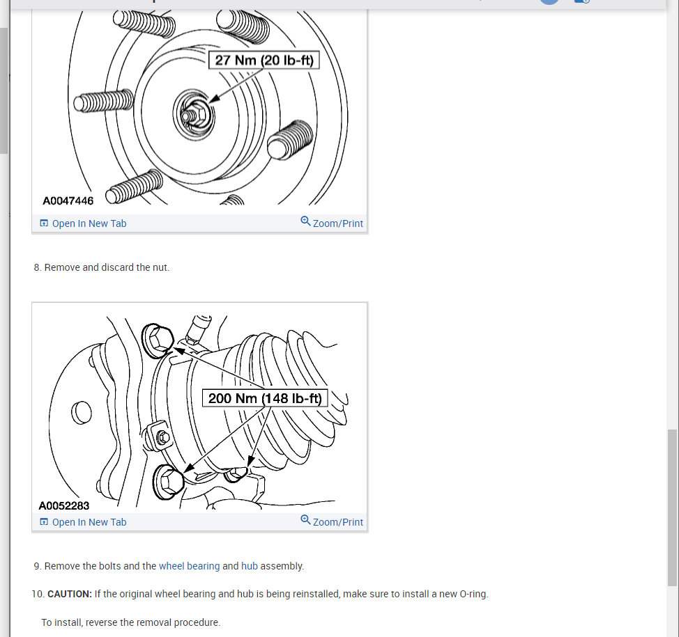

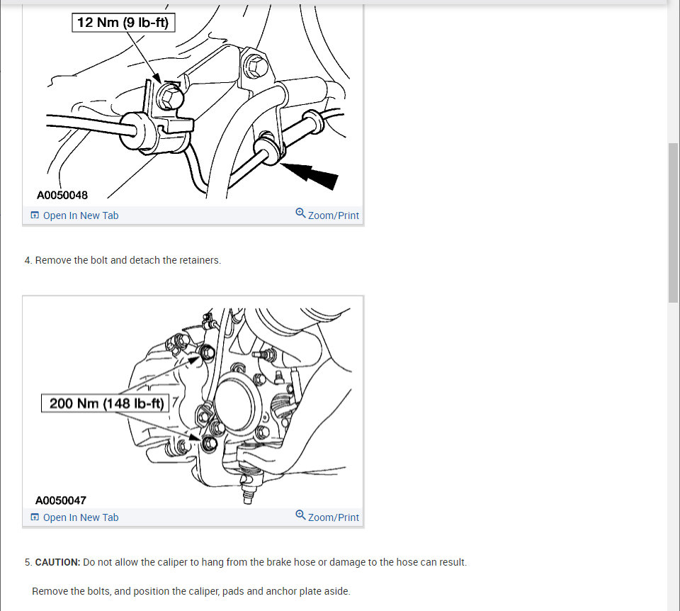

Below you will find the process from the manual on how to replace the hub.
Please run through this material and let us know if you have other questions. Thanks
