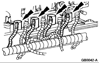

how do I change # 5 ignition coil

Is your Ignition System a direct ignition system or coil on plugs? Also what engine liter, and is it a 2WD or a 4WD?

IT IS COIL ON PLUG, 5.4 2 WHEEL DRIVE

REMOVAL
https://www.2carpros.com/forum/automotive_pictures/12900_c1_2.gif
Disconnect the ignition coil electrical connection.

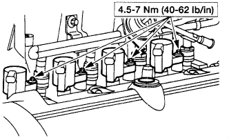

https://www.2carpros.com/forum/automotive_pictures/12900_c2_2.gif
Remove the bolts.

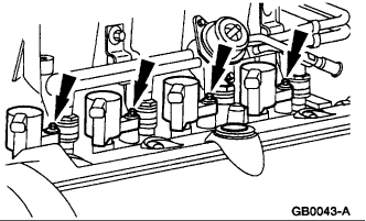

https://www.2carpros.com/forum/automotive_pictures/12900_c3_8.jpg
Remove the ignition coils.

Follow the removal procedure in reverse order.

The number fiive coil is located drivers side very first coil. You may have to disconnect the injector connector to access the 7mm bolt holding the coil in.
