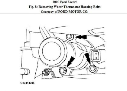

Read temperature on thermometer. This is the initial opening temperature and should be within specification. Continue heating water until thermostat is fully open and note temperature. This is the fully open temperature. If either reading is not to specification, replace thermostat.[/quote:8e4d9a94c5]Thanks I'll try that[/quote:8e4d9a94c5]were is the thermostat located

Thermostat Removal (Escort) Disconnect the battery ground cable. Remove the air cleaner outlet tube (9B659).. Drain the engine coolant to a point below the water thermostat (8575). Disconnect the water temperature indicator sender unit and the engine coolant temperature sensor electrical connectors. Disconnect the upper radiator hose (8260) and the heater coolant hose from the water thermostat housing. Remove the water thermostat housing bolts, the water thermostat housing, and the water thermostat.
https://images.2carpros.com/forum/automotive_pictures/266999_therm_4.jpg
