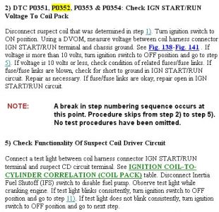

I still have the problems I've mentioned before, I took the car to get a computerized diagnostic and
the reading that came out was: Ignition coil B Primary/Secondary circuit malfunction.(PO352)
Does this have anything to do with the misfiring of the cilinders?
I have changed the crankshaft sensor, the O2 sensor, the spark plugs, checked the gas pump, and gas filter(they are ok.)Also the plug wires were changed.

SERVICE WRITER
  • 9,123 POSTS
Check the coil pack, It directly has to do with the misfiring.
https://www.2carpros.com/forum/automotive_pictures/30961_po352_1.jpg
