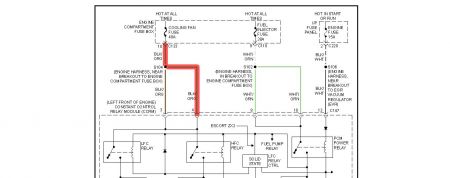

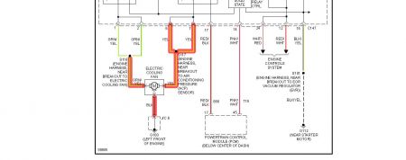

I checked the fan and it good, has good 40 amp, still wont come on
Monday, September 6th, 2010 AT 7:39 AM
5 Replies
MECHANIC
75,992 POSTS
Check and test the engne coolant temperature sensor/gauge sender switch
Saturday, June 6th, 2020 AT 12:46 PM
RKAHLE
MEMBER
3 POSTS
Ok changed the unit pulled the fan assy and checked it fan works if I hot wire it, but not with how it should be working.
+1
MECHANIC
75,992 POSTS
Check the fan relay in the CCRM if okay test the engine coolant temperature sensor/gauge switch
+1
RKAHLE
MEMBER
3 POSTS
How do you check a ccrm?
+1
MECHANIC
75,992 POSTS
If the coolant temperature sensor/switch is okay the problem could be the CCRM or the computer itself
