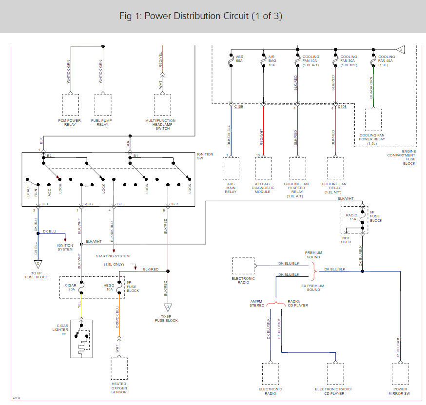

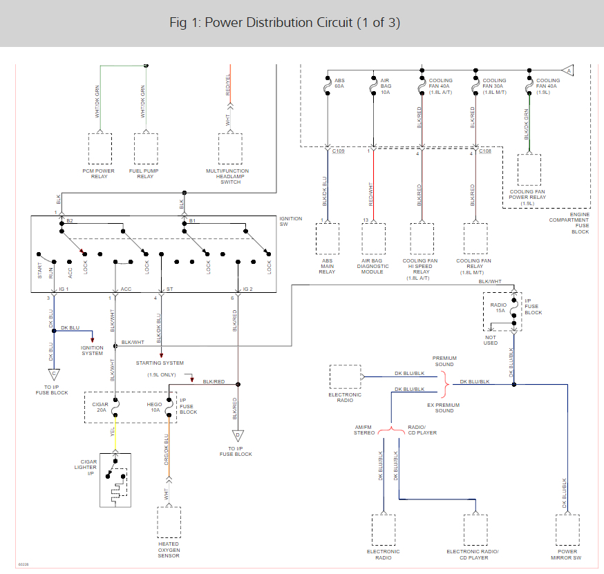

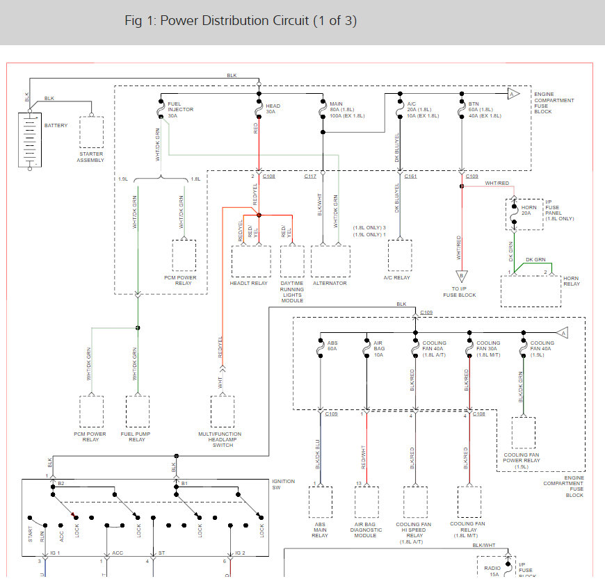

ASHLEIGH
  • 1992 FORD ESCORT
Electrical problem
1992 Ford Escort
I need the electrical skematic for this make and model my chiltons shows me the skematic for a 97-2003 im not sure if it is the same design. I have replaced the igniton switch twice in my vehicle within the last 6 months the mechanic told me the part/s he ordered were from the factory supposed to be brand new now I am fed up and I am going to put a toggle in and a push button help thank you
Monday, October 8th, 2018 AT 11:19 AM (Merged)
DAVE H
  • 13,384 POSTS
You may have to save this to your computer to enlarge it ...
https://www.2carpros.com/forum/automotive_pictures/266999_elec_1.jpg

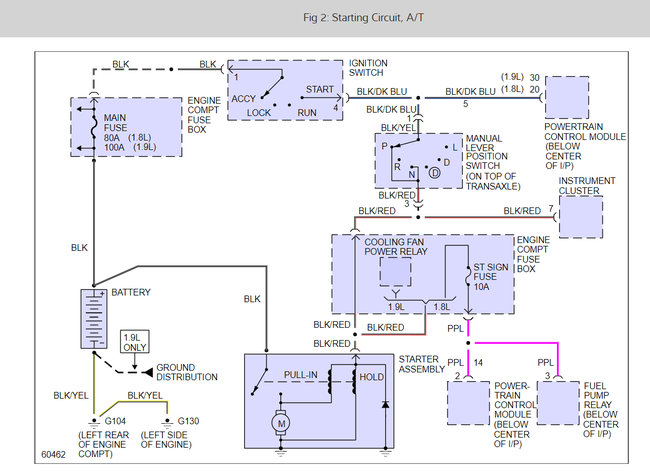

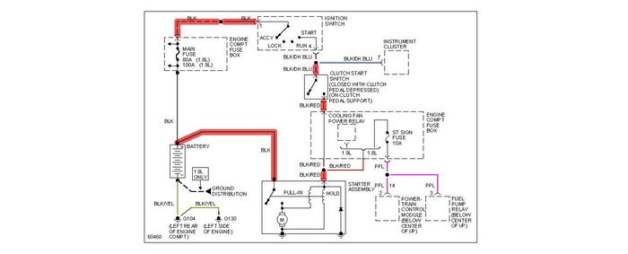

JTTRUNK
  • 1994 FORD ESCORT
  • 4 CYL
  • FWD
  • MANUAL
  • 160,000 MILES
Hey guys! I have a 94 escort 1.9L lx wagon manual trans. My ignition lock cylinder broke and I'm going to install toggle switch and push start button. The problem I face is the wiring, on the ignition switch there is 2 lrg black constant 12v (one connector) and 4 wires (smaller gauge then the 2 black) on a different connector, the colors are B/R, BL, B/W and B/DBL. I believe the B/DBL is to the stater solenoid. I plan on leaving the ignition switch in the RUN position and installing toggle(s) for ACC/RUN and a momentary push button for the STARTER.
Can one of you please explain which wires to connect to toggle(s)? The 2 black 12v constant are confusing me. Do I need 2 toggles, or a 3 pole toggle?
Monday, October 8th, 2018 AT 11:20 AM (Merged)
  • 75,992 POSTS
You need a push button in between one big black wire and the black/dark blue to engage the starter.
You will need on off on toggle for the power wires for the ign1, ign2 and accessory.
Check out the diagrams below by clicking on them
-1
JTTRUNK
I'm planning on keeping the ignition switch in the run position do I still need to jumper the clutch switch? And what is the point of the 2 constant 12v black wires. I just dropped $1500.00 on suspension and brake parts, can't afford to mess up my engine or anything else. Would it be safer to install 3 pole toggle so I can splice into both black constants?
CARADIODOC
  • 34,449 POSTS
Yes you can leave the ignition switch int he on position you will be fine.
