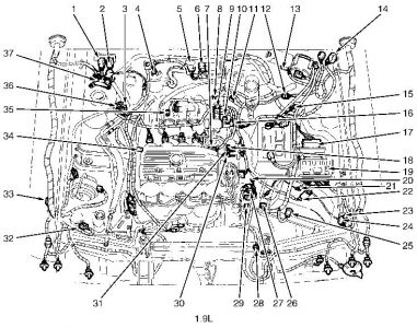

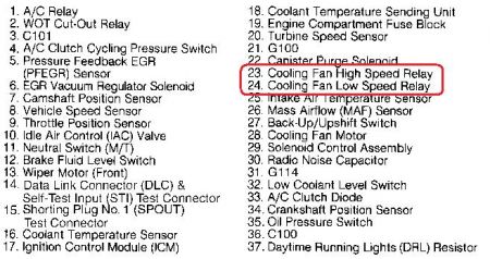

Could you tell me where cooling fan speed relay is located?
