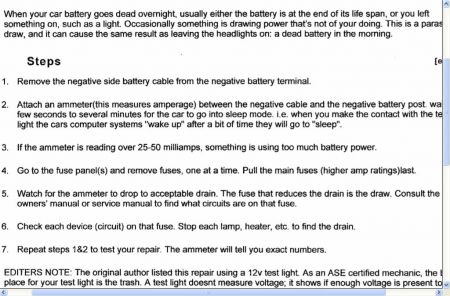

Rule out the battery and alternator by getting it load tested and then look for a short circuit within the electrical system
https://www.2carpros.com/forum/automotive_pictures/12900_parastic_draw_1_17.jpg
