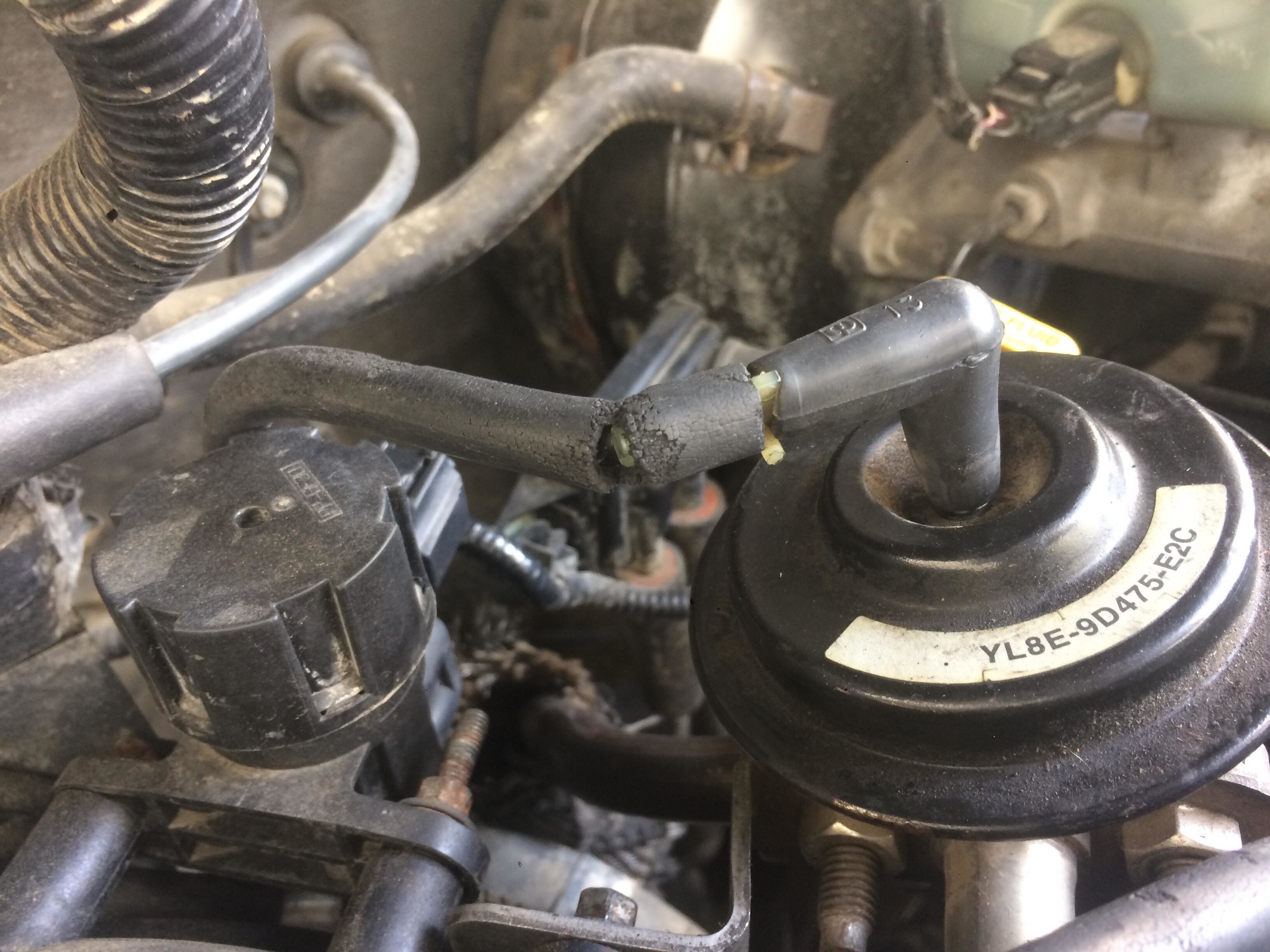

No, I cannot see if it is moving.
Tuesday, June 26th, 2018 AT 8:52 AM
MECHANIC
52,796 POSTS
Remove the valve and run the engine and see if it moves with the line attached?
Tuesday, June 26th, 2018 AT 8:53 AM
GIGISULAMANIDZE1
MEMBER
88 POSTS
Hi, I removed EGR and car start idling but EGR not moving.
Thursday, June 28th, 2018 AT 2:58 AM
MECHANIC
52,796 POSTS
Okay, when it was idling did you hear a loud exhaust leak, and a loud exhaust noise as well?
Thursday, June 28th, 2018 AT 5:56 AM
GIGISULAMANIDZE1
MEMBER
88 POSTS
Yes.
Thursday, June 28th, 2018 AT 8:36 AM
MECHANIC
52,796 POSTS
Okay, was there a loud hissing noise from a very large vacuum leak? Did the engine stumble and almost shut off?
If it did not then that passageway is blocked and that is why the code is setting.
Thursday, June 28th, 2018 AT 4:28 PM
GIGISULAMANIDZE1
MEMBER
88 POSTS
When I started car, car almost shut off, but than she was idling, sound was very loud.
Thursday, June 28th, 2018 AT 9:57 PM
MECHANIC
52,796 POSTS
Okay, sounds like the passages are clear.
Did you replace the EGR valve?
Friday, June 29th, 2018 AT 4:49 AM
GIGISULAMANIDZE1
MEMBER
88 POSTS
Hi, I replaced EGR but MIl is still on. Today I checked EGR hose and it was broken maybe it is a problem.
Image (Click to make bigger)
Monday, July 2nd, 2018 AT 12:53 PM
MECHANIC
52,796 POSTS
It sure can be. It will not allow the valve to open.
