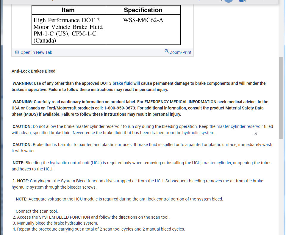

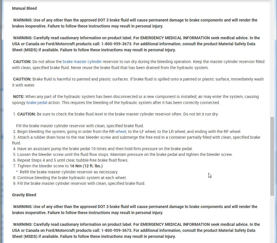

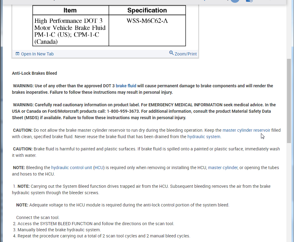

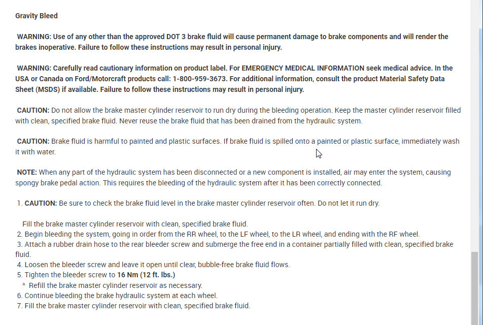

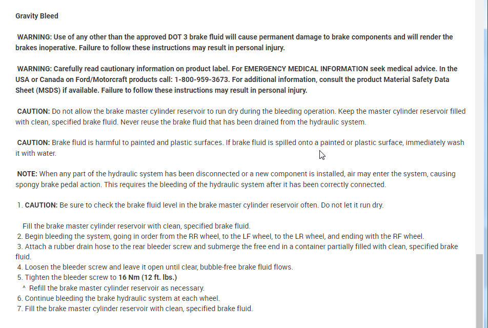

Hello, Today the mechanic told us that the brakes needs to bleed can you help me?
Wednesday, June 16th, 2010 AT 10:24 PM
MECHANIC
18,907 POSTS
Sure. Here is a video that will help with this:
https://youtu.be/ye64wlARgcs
Plus below is the process from the manual that will give the detail as well on how to do this.
Please let us know if you have other questions. Thanks
