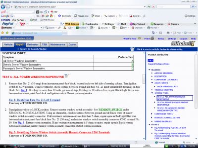

The fuse you need ti check is #21 a 30amp...
http://www.2carpros.com/forum/automotive_pictures/62217_E150Windows_1.jpg
