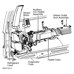

i need a new fan motor in my rear heat/ac unit. can i do this from the inside of my van or do i have to go from ??????

AUXILIARY A/C-HEATER ASSEMBLY Removal & Installation Remove third, fourth and fifth bench seats (if equipped). Drain cooling system. Disconnect heater hoses located under left side of body. Remove trim. Discharge A/C system using approved refrigerant recovery/recycling equipment. Disconnect refrigerant lines. See Fig. 1. Disconnect rear A/C-heater assembly harness connectors. Remove mounting bolts, and lift assembly off locating dowel pin. Remove heater assembly while guiding heater hoses through from underbody. To install, reverse removal procedure. Fig. 1: Removing Auxiliary A/C-Heater Assembly

Thanks David H. for the advise you gave me on changing out my rear fan motor. This is more than I can personally do without having a recovery pump to properly discharge my ac unit. They didn't make this fix for us back yard mechs.
