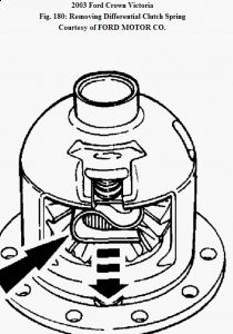

I am removing the rear axle to change the wheel bearings which have blown. I have removed the wheel and opened up the diff, removed the pin and am now trying to push the axle in to pull out the c-clip. It will not move forward enough. After inspecting the axle, I found that the seal blew out and is now stuck inside the speed sensor ring and is preventing me from pushing the axle forward to access the c-clip. How can I get the axle off with the broken seal in the way?

Nothing else should stop that axle from being pushed in. It's possible the axle is grooved and the bearings are sticking in the groove. Just hit the axle with a small sledge hammer. This video with show you how the differentials are very similar.

The '05 Crown Vic has rear disc brakes and the axle is stuck because the seal came out of the shaft and is now stuck between the speed sensor ring and the shaft housing. The axle will not slide in until the seal is removed from between the two. Any ideas on how to either get the seal back into the shaft or remove it so that the axle can move into the housing and give me room to release the c clip.

There's no magic trick to getting this done. It has to come out one way or the other. Pull the axle out as far as you can and see if you can get the seal lined back up with a screwdriver

Can't get c-clips out because of spring between axle ends. It's a police interceptor.

First, there is a tech bulliten on these axles have a look, if you dont use the new part numbers, you will do the work again.
AXLE - REAR AXLE SHAFT AND/OR AXLE BEARING PREMATURE WEAR TECHNICAL SERVICE BULLETIN Reference Number(s): 03-5-5, Â Date of Issue: Â March 17, 2003 Superceded Bulletin(s): 02-25-3, Â Date of Issue: Â December 23, 2002 Related Ref Number(s): 02-25-3, 03-5-5 ARTICLE BEGINNING DESCRIPTION AXLE - REAR AXLE SHAFT AND/OR AXLE BEARING PREMATURE WEAR - VEHICLES PRODUCED BEFORE 1/1/2003 ONLY ISSUE Some 2003 Town Car (except Limo and Hearse chassis), Crown Victoria and Grand Marquis vehicles produced before 1/1/2003, may exhibit rear axle shaft and/or axle bearing premature wear. This is caused by excessive load, temperature, and inadequate lubrication. ACTION To service, install Rear Axle Bearing Service Kit, Part Number 3W1Z-4A109-AA. Refer to the instruction sheet included with the service kit. PARTS INFORMATION PARTS INFORMATION WARRANTY INFORMATION WARRANTY STATUS: Eligible Under The Provisions Of Bumper To Bumper Warranty Coverage. WARRANTY INFORMATION FORD: 2003 Crown Victoria LINCOLN: 2003 Town Car MERCURY: 2003 Grand Marquis NOTE: This bulletin supersedes Technical Service Bulletin 02-25-3 dated December 23, 2002. Article 02-25-3 is being republished in its entirety to update the model line coverage. Part Number Part Name 3W1Z-4A109-AA Rear Axle Bearing Service Kit Operation Description Time 030505A Install Axle Bearing Service Kit 1.5 Hrs. Page 1 of 2 AXLE - REAR AXLE SHAFT AND/OR AXLE BEARING PREMATURE WEAR -200... 3/14/2009 Check your production date to see if it appies to yours,
https://www.2carpros.com/forum/automotive_pictures/62217_spring_1.jpg
Of course you need to pull that center pin the pull the spring out. Use the friction modifier with the new oil.
https://www.2carpros.com/forum/automotive_pictures/62217_toolsb_1.jpg
