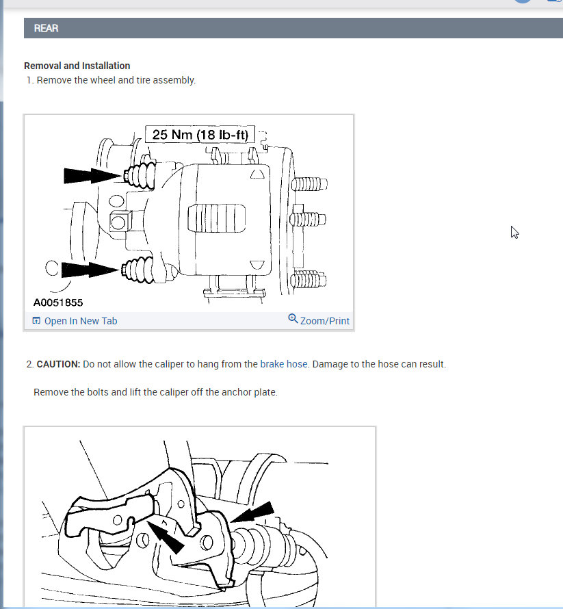

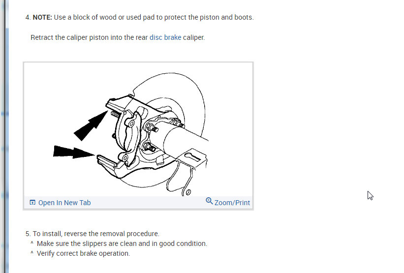

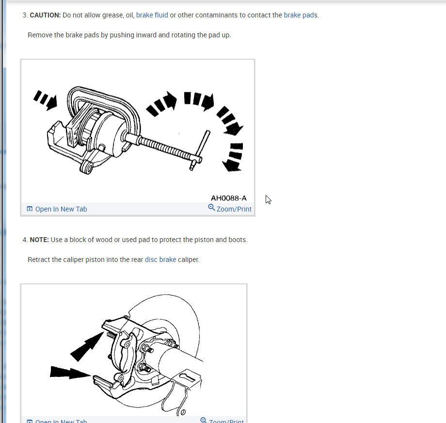

Hi - can you please help me do a brake job?
Friday, July 25th, 2008 AT 5:27 PM
MECHANIC
18,907 POSTS
Sure. Here is a guide that will help with this:
https://www.2carpros.com/articles/how-to-replace-rear-brake-pads-and-rotors
Below you will find the process from the manual on how to replace the rear pads. Please let us know if you have questions. Thanks
