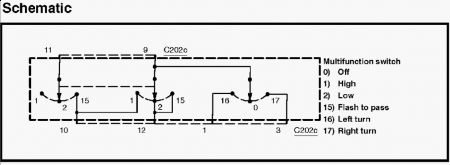

Is the a/c blower motor affected when you hit the gas? Headlights have flash to pass and the brake light wire both go thru the MFS. Test MFS like this:
http://www.2carpros.com/forum/automotive_pictures/62217_MFS1_1.jpg
http://www.2carpros.com/forum/automotive_pictures/62217_MFS2_1.jpg
http://www.2carpros.com/forum/automotive_pictures/62217_MFS3_1.jpg

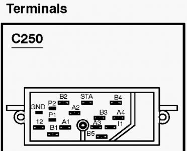

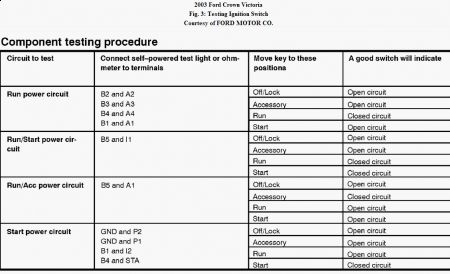

While your in there test ignition switch.
http://www.2carpros.com/forum/automotive_pictures/62217_IGN1_1.jpg
http://www.2carpros.com/forum/automotive_pictures/62217_IGN2_1.jpg
http://www.2carpros.com/forum/automotive_pictures/62217_IGN3_1.jpg
