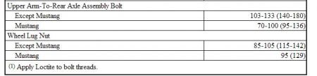

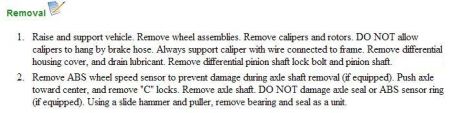

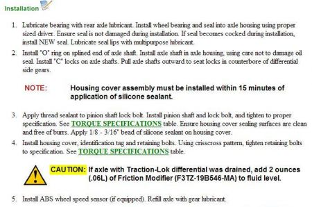

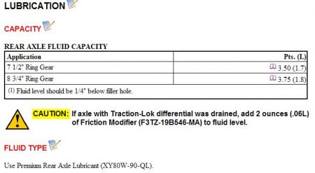

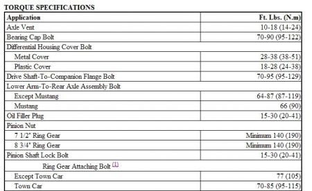

How do I replace a rear axle bearing on a 1999 crown vic?
Sunday, January 11th, 2009 AT 12:10 AM
BLUELIGHTNIN6
MECHANIC
16,542 POSTS
Hello
Below are instructions you requested.
Hope this helps..
