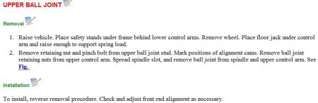

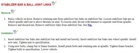

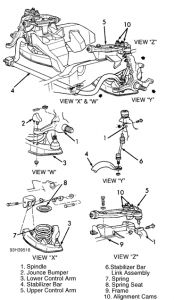

My husband, unwilling to ask anyone?S (lol), is having a hard time trying to fix the upper ball joint, and stabilizer joint in our car. Can you please let me know how? Thanks!

https://www.2carpros.com/forum/automotive_pictures/261618_Noname_2905.jpg
https://www.2carpros.com/forum/automotive_pictures/261618_Noname2_958.jpg
https://www.2carpros.com/forum/automotive_pictures/261618_Noname3_344.jpg
