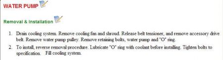

Having trouble removing water pump on my 1994 ford Marquis. Can I get step by step instructions on how to remove it?

Hello
Replacement procedures are below for Ford Crown Victoria (as listed in your title)..please let me know if you need it for the Marquis instead.?
Let me know if you need further assistance..
