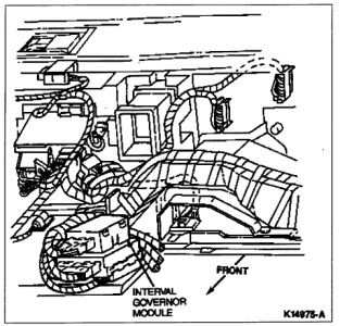

Were is the wiper control module located on a 1992 crown vic?--My wipers work sometimes and sometimes they stop in the middle of the windshield.

Hello With the miles you have, it may be the wiper motor also.
https://images.2carpros.com/forum/automotive_pictures/248015_1_68.jpg
Disconnect battery ground cable. Remove the split steering column cover retaining screws. Separate the two halves and disconnect the multiple connector at the rear of the wiper switch. Disconnect the multiple connector at main wiring loom. Remove the two governor retaining screws. To install, reverse Removal procedure.
