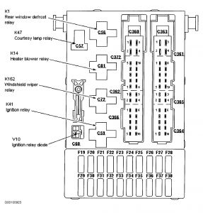

I have no heat in my car, (I live in Minnesota), and have no car manual, how do I look to see if the fuse is blown. I was told it was the blower motor, and the person left something hanging from under the glove compartment on the passenger side.

you want fuse #F37 it is 30 amp CENTRAL JUNCTION BOX NOTE:Central Junction Box (CJB) is located under driver's side of instrument panel, near steering column. Central junction box may also be referred to as passenger compartment fuse panel this is the fuse setup.for vehicles manufactured after 05/03/99 if you have any probles please let me know Don't get disheartened there are a few GOOD, HONEST mechanic's out here ??
https://images.2carpros.com/forum/automotive_pictures/266999_fuse_2.jpg
