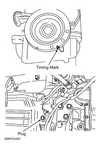

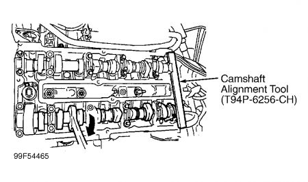

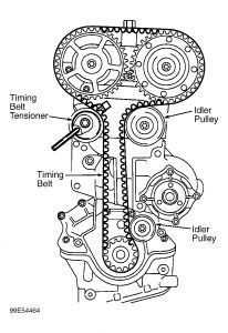

I've recently changed my timing belt and have no idea what the specs are could you help me please I've been without a car for two weeks

You need a specail tool
here some pic
good luck
