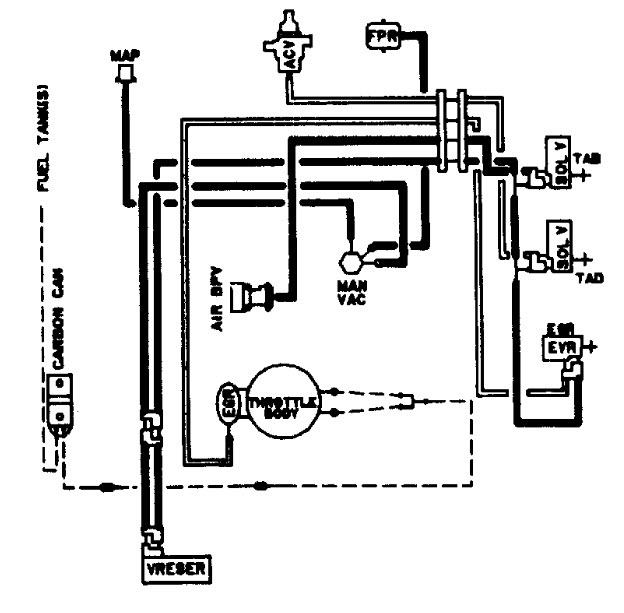

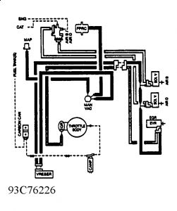

Can I get the engine vacuum line routing?

https://www.2carpros.com/forum/automotive_pictures/188069_93broncoemission_1.jpg

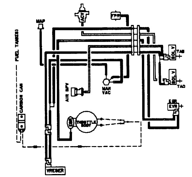

HMAC300
  • 48,601 POSTS
There are 2 different ones i'm sending both. Make sure to read this index. Yours is only figure 4&5, figure 5 second drawing.
