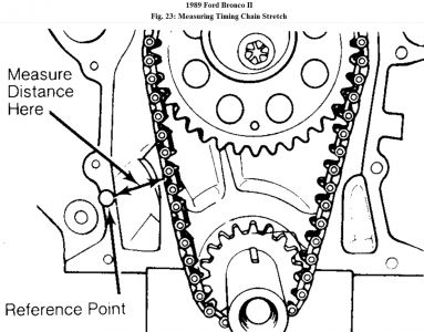

no power at 10 btdc. runs great at 22 btdc. cannot pass smog test with timing set this far advanced. i was told it might be timing chain. help?

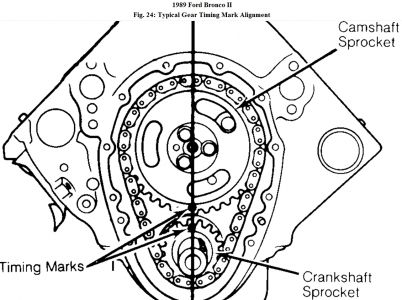

Timing chains will stretch during operation. Limits are placed upon amount of stretch before replacement is required. Timing chain stretch will alter ignition timing and valve timing. To check timing chain stretch, rotate crankshaft to eliminate slack from one side of timing chain. Mark reference point on cylinder block. Rotate crankshaft in opposite direction to eliminate slack from remaining side of timing chain. Force other side of chain outward and measure distance between reference point and timing chain. See Fig. 23 . Replace timing chain and gears if not within specification. Fig. 23: Measuring Timing Chain Stretch Timing chains must be installed so timing marks on camshaft gear and crankshaft gear are aligned according to manufacturer. See Fig. 24 . Fig. 24: Typical Gear Timing Mark Alignment

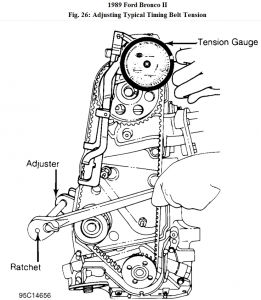

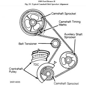

Cogged tooth belts are commonly used on overhead cam engines. Inspect belt teeth for rounded corners or cracking. Replace belt if it is cracked, damaged, missing teeth or oil soaked. Used timing belt must be installed in original direction of rotation. Inspect all sprocket teeth for wear. Replace all worn sprockets. Sprockets are marked for timing purposes. Engine is positioned so that crankshaft sprocket mark will be upward. Camshaft sprocket is aligned with reference mark on cylinder head or timing belt cover and then timing belt can be installed. See Fig. 25 . Fig. 25: Typical Camshaft Belt Sprocket Alignment TENSION ADJUSTMENT If guide rails are used with spring loaded tensioners, ensure at least half of original rail thickness remains. Spring loaded tensioner should be inspected for damage. Ensure all timing marks are aligned. Adjust belt tension using manufacturer's recommendations. Belt tension may require checking using tension gauge. See Fig. 26 . Fig. 26: Adjusting Typical Timing Belt Tension TIMING GEARS * PLEASE READ THIS FIRST *

The bottom gear is actually the crankshaft, the picture shows it as a second camshaft...
