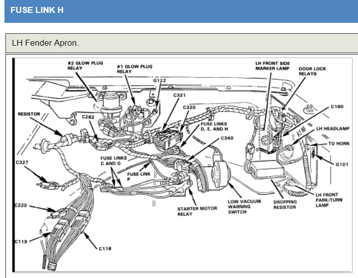

When I turn the ignition switch to the "start" position, the truck will start. But when I release the switch and it returns to the "power on" position the truck dies. I first noticed this when the radio and the elect. Windows would not operate unless I keep a foward motion on the key switch. Not to the "start" position but to the "power on" position. I have removed the steering wheel, replaced the key switch, cleaned and lubricated all mechanical parts and cleaned all electricial contacts. My grandson is giving me a fit about not takeing him fishing, so please help me exorcise this demon.

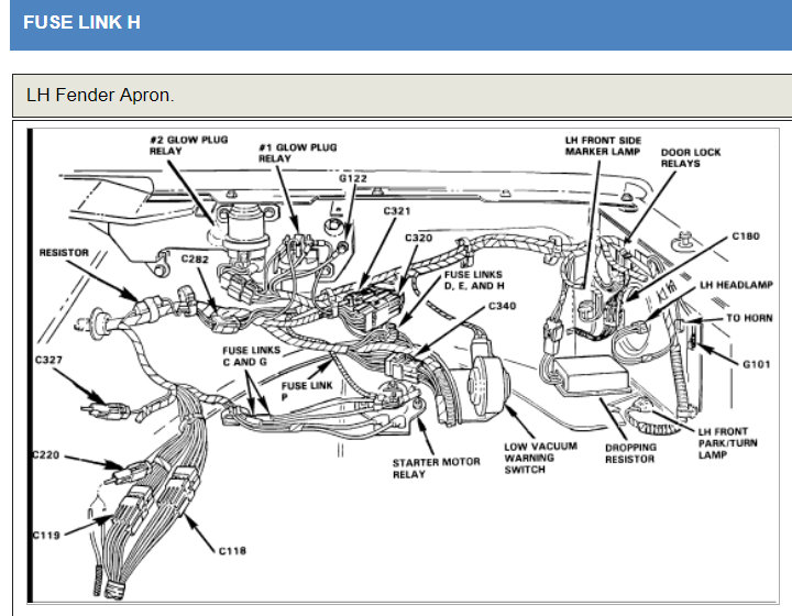

Sounds like your fusible links up by the starter solenoid have gone bad just tug on them to see if one is rubbery. Here is the location also check by the starter solenoid.
Check for power at the ignition switch and through the fusible links
