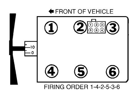

I WAS REPLACING THE WIRES TODAY, DOING THEM ONE BY ONE AND GOT PHONE CALLS SO MY BUDDY TOOK THE WIRES OFF AND CAN''T REMEMBER WHICH ONE GOES WHERE---NOW IM STUCK AND CANT REMEMBER WHICH WIRE GOES ON WHICH PLUG--DO YOU KNOW WHERE I CAN GET A DIAGRAM TO USE SO I CAN PUT MY WIRES BACK ON THE RIGHT WAY AND KEEP THIS DIAGRAM IN A FILE FOR THE NEXT TIME I CHANGE WIRES---I HAVE USED YOU GUYS BEFORE AND U GIVE GREAT HELP, NOW I NEED YOUR HELP AGAIN--CAN U SEND ME A DIAGRAM OF WHICH WIRE GOES WHERE? THANK YOU AND HAVE A BLESSED DAY MY FRIENDS BRIAN
OH I HAVE A 3.0 ENGINE AND IT HAS AC TOO

https://images.2carpros.com/forum/automotive_pictures/12900_fo_122.jpg
