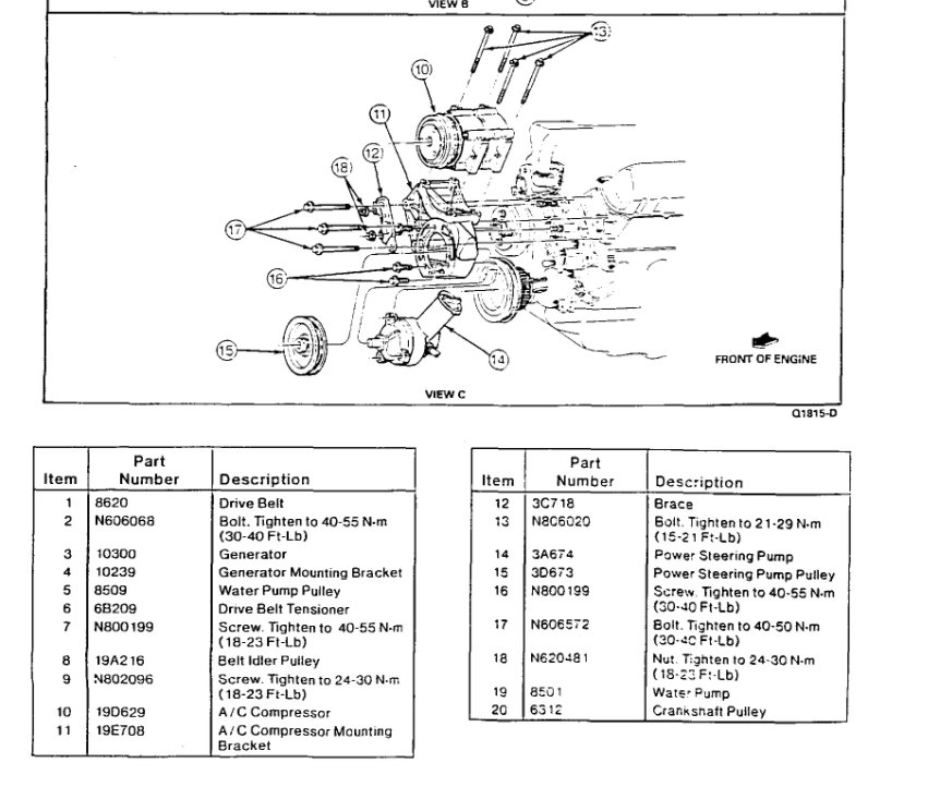

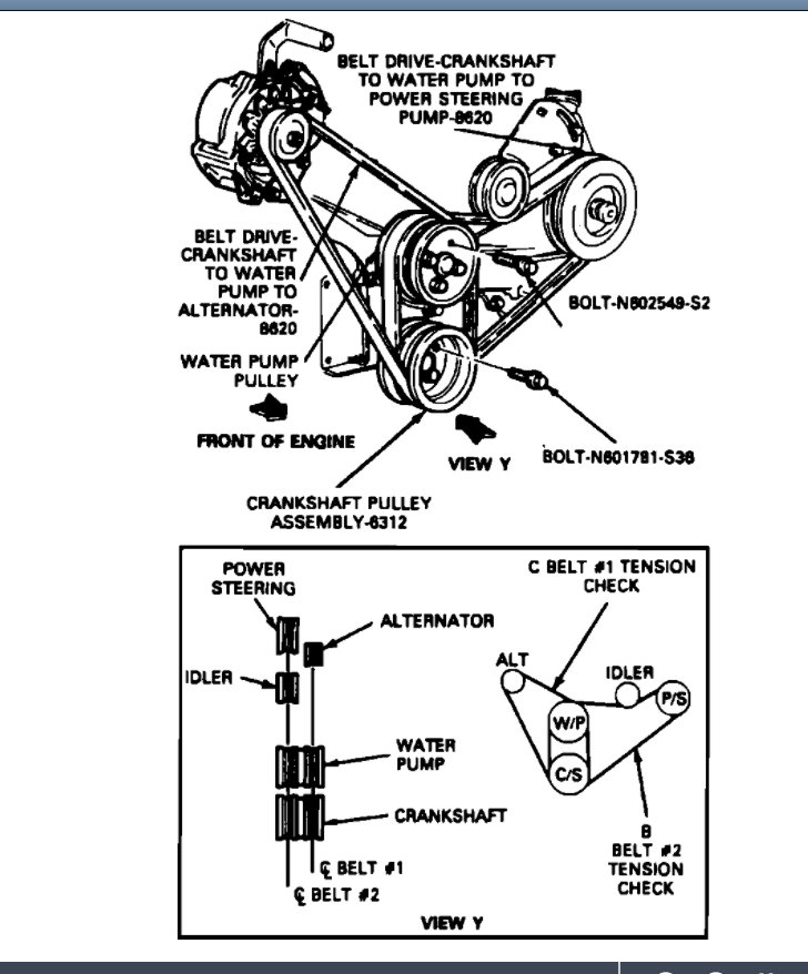

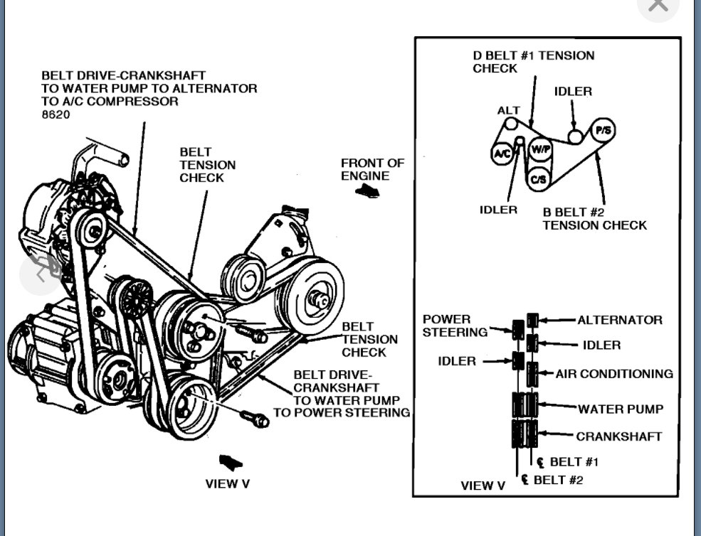

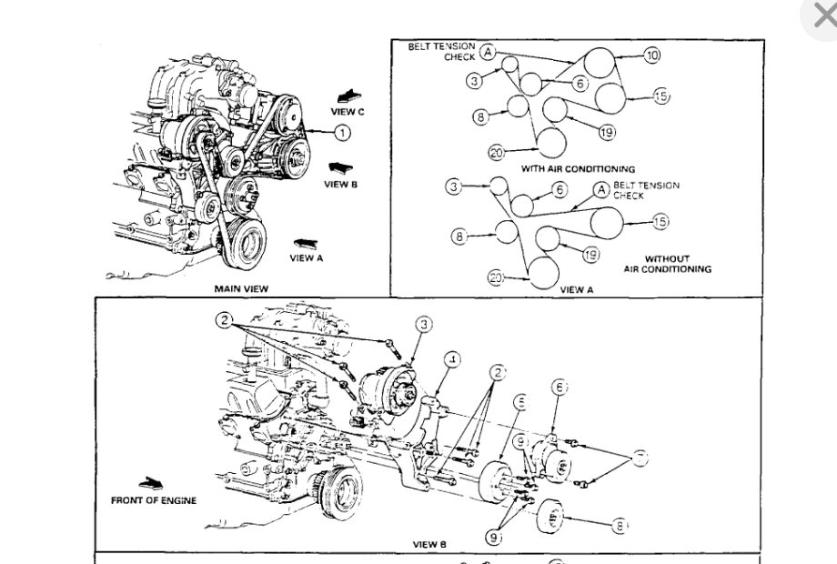

I just need a diagram for the belts on this van

I am attaching the diagrams below but here are a couple of guides that will help with this:
https://www.2carpros.com/articles/how-a-serpentine-belt-works
The first 2 diagrams below are for a 3.0L with and without A/C. The next two are for the 4.0L with and without A/C.
Please run through all this info and let us know if you have more questions.
