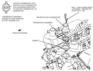

Where is the thermostat located. How do I replace it.

What engine size? 2.3L 3.0L etc..
Diagram of thermostat location is below..
