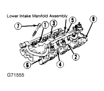

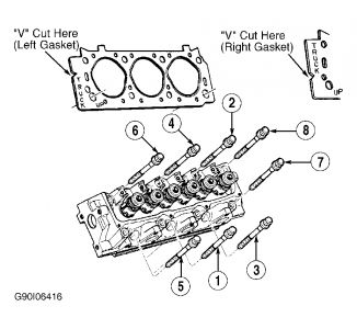

CYLINDER HEAD
Removal
Remove upper and lower intake manifolds. See, in this article, INTAKE MANIFOLDS under REMOVAL & INSTALLATION. Remove accessory drive belts and idler. When removing left cylinder head, remove power steering pump bracket retaining bolts. Remove power steering pump and bracket as an assembly (with hoses attached).
On Aerostar, remove ignition coil bracket and coil. On all models, remove dipstick tube retaining nut from exhaust manifold. Rotate or remove dipstick tube. When removing right cylinder head, remove alternator bracket and adjusting arm.
Remove spark plugs. Remove exhaust manifolds. See, in this article, EXHAUST MANIFOLDS. Remove PCV valve and valve covers. See VALVE COVERS.
Loosen rocker arm bolts and move rocker arm off push rod. Keep push rods in order for installation reference, and remove push rods. Remove and discard cylinder head retaining bolts. Remove cylinder head and gasket.

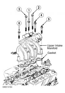

INTAKE MANIFOLDS
NOTE:Upper and lower intake manifold service procedures are covered separately.
Removal (Upper)
Disconnect negative battery cable. Remove air cleaner duct hose. Remove throttle linkage shield and disconnect linkage. Mark and disconnect vacuum hoses from throttle body. Mark and disconnect electrical connectors.
Disconnect PCV hose. Remove alternator support brace. Remove 6 upper intake manifold assembly bolts. Remove upper intake manifold assembly and gasket.

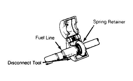

Removal (Lower)
Disconnect negative battery cable. Drain cooling system. Remove air cleaner duct hose. Relieve fuel pressure. See, in this article, FUEL PRESSURE RELEASE under REMOVAL & INSTALLATION. Using Disconnect Tool (D87L-9280-A) for 3/8" line or (D87L-9280-B) for 1/2" line, disconnect fuel supply and return lines. See Fig.
Remove throttle linkage shield and disconnect linkage. Mark and disconnect vacuum hoses from throttle body. Mark and disconnect electrical connectors. Disconnect upper radiator hose from thermostat housing. Remove ignition coil from throttle body.
Remove throttle body. Remove alternator support brace. Disconnect fuel injector harness connectors. Disconnect heater hoses. Mark distributor housing location and note rotor position. Remove distributor. Remove valve covers. See VALVE COVERS.
Loosen cylinder No. 3 intake valve rocker arm. Rotate rocker arm off push rod. Remove push rod. Remove intake manifold retaining bolts. Remove alternator if necessary. Remove intake manifold.

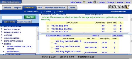

  • 75,992 POSTS
Estimates/Quotes:
NOTE: Total costs varies with locations labor could range from $70.00-$130.00 per hr
https://www.2carpros.com/forum/automotive_pictures/12900_aerostar_1.jpg
