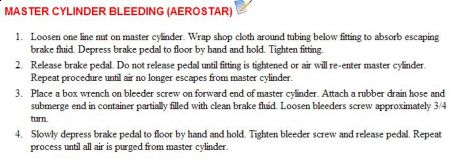

I installed a master cylinder on a 1990 Ford Aerostar. The instructions said not to bench bleed as this can cause leaks. I bled it once it was installed on the vehicle using the bleed screw, but I am still getting air. What do I need to do?

Clutch or brake master cylinder?
+1
Sunday, June 21st, 2009 AT 11:16 PM
ILUVMYTRUCK1965
Brake
Monday, June 22nd, 2009 AT 5:43 AM
BLUELIGHTNIN6
  • 16,542 POSTS
Okay, if there is still air in the lines then you will just have to go over the process again. Below are the proper bleeding procedures for your vehicle's master cylinder..
