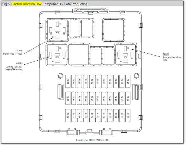

U2023 vehicle connection network fault, what does this mean and what can I try to fix it? ABS still works and car drives fine but isn't boosting as much. That's all I can tell you. When the fault is on cant turn off traction control and once reset takes a while for the light to come back on.

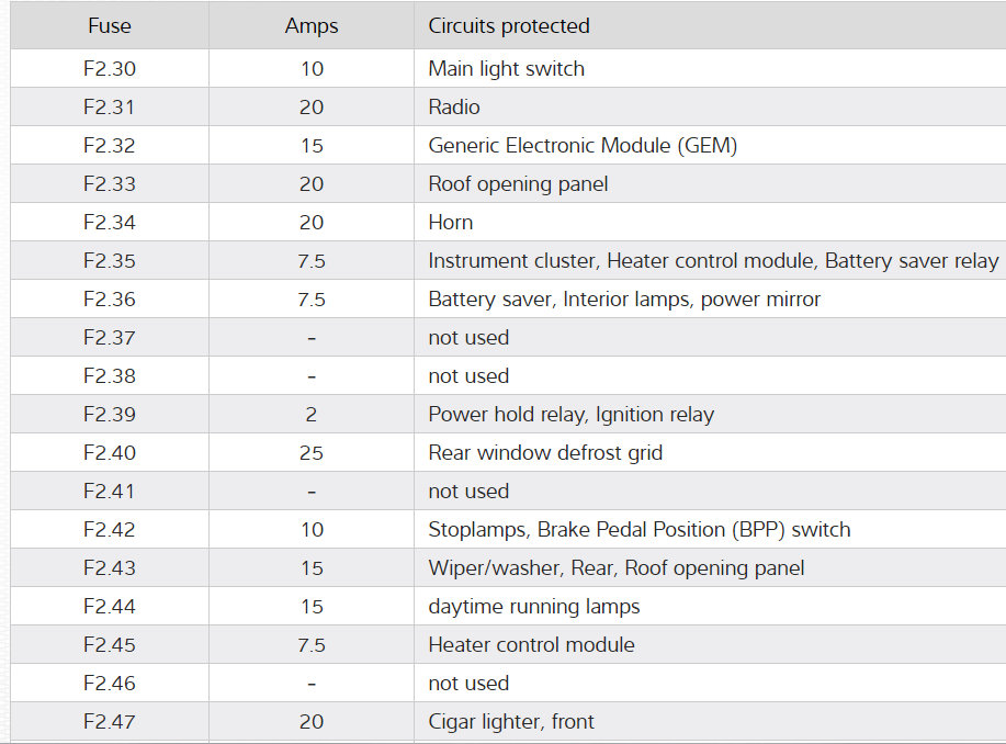

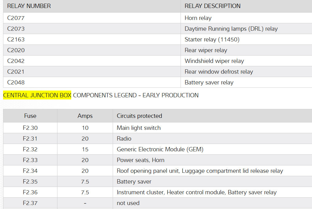

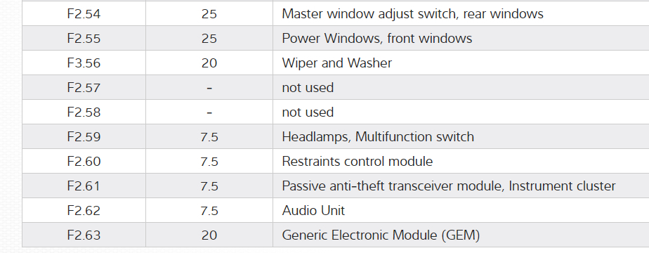

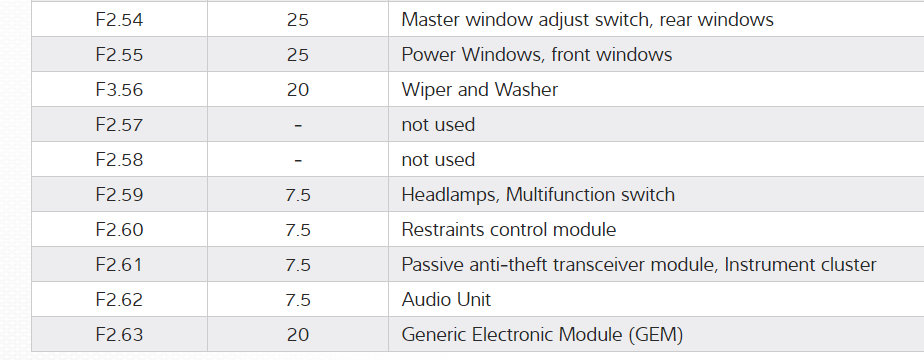

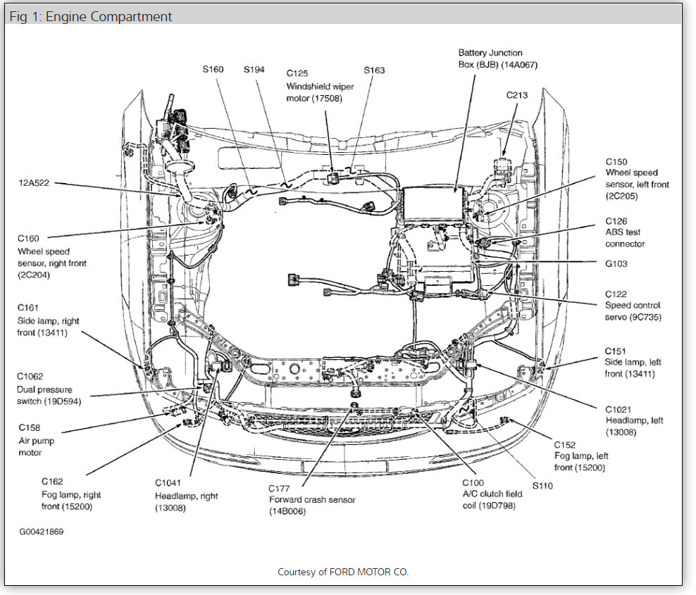

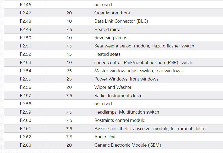

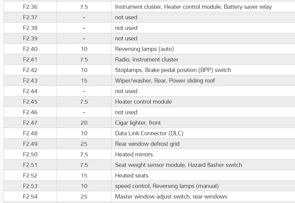

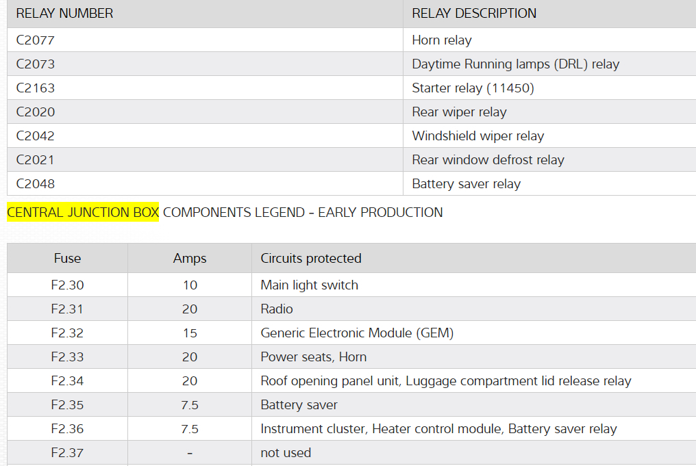

This code is telling you one of a few modules is not communicating correctly they list is as follow's, PCM, safety restraint control module, ABS module, instrument cluster, CAN not communicating with PCM correctly or the GEM not doing its job. When the light comes on is there anything else that won't work besides the trac control? It sounds like the ABS control module is not working right I have seen this problem. I would check fuse number 63 and 32 which go to the BCM, should be located in the central junction box (F2 fuses).
Here is guide and fuse locations:
Check out the diagrams (below). Please let us know what you find.

Thanks for the help I got around to check the fuses and 63 was blown. I replaced it and it blew again so I checked the GEM and it had rust on it like it was under water lol found the problem. I love this site
