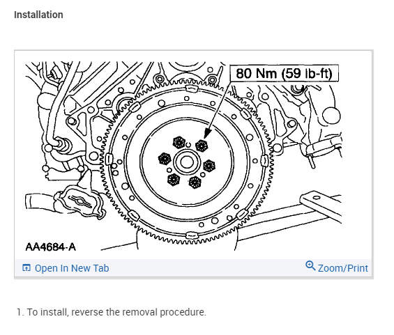

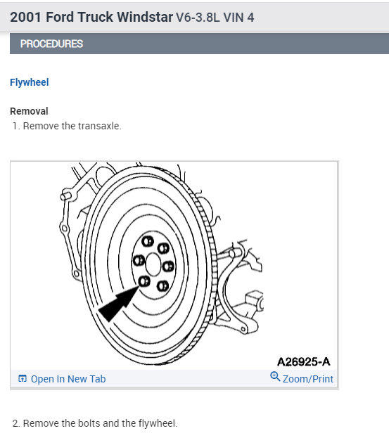

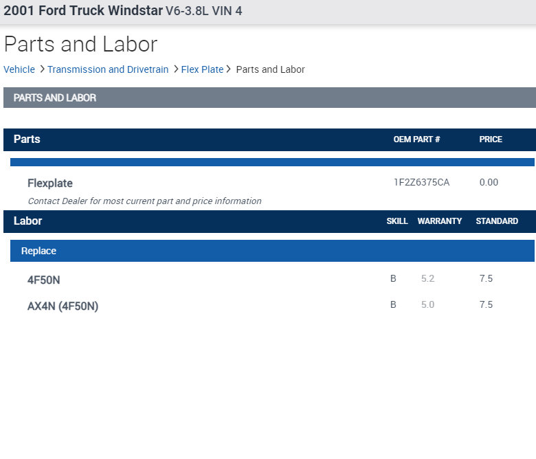

Can any other Windstar flywheel fit a 2001 Ford Windstar SE 3.8L V6?
Saturday, January 22nd, 2022 AT 8:57 AM
SQM
MECHANIC
6,383 POSTS
On this Windstar 3.8L, the flywheel/flex plate OEM part number is 1F2Z6375CA.
This part was used in 2001 and 2002 Windstar's.
Images (Click to make bigger)
