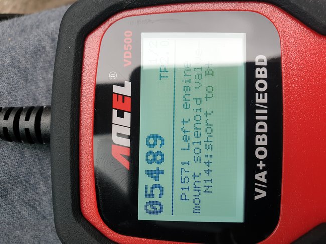

JAY JACKSON
  • 6 POSTS
Hi Joe, I purchased a code reader and it is saying that both engine mounts need changing, so I think you are spot on.
Mar 20, 2019 at 11:36 AM
JOETECHPRO
  • 705 POSTS
Hey JAY JACKSON,
Have you checked for leaks at the mounts?
What codes have you got stored?
Regards, Joe
Mar 20, 2019 at 11:57 AM

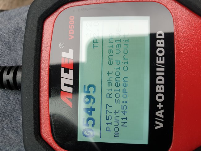

JAY JACKSON
  • 6 POSTS
Hi Joe, did a scan and this is what came up.
Mar 22, 2019 at 7:34 AM
JOETECHPRO
  • 705 POSTS
Hey JAY JACKSON,
I would say still check the engine mounts for leaks and replace if leaking.
It looks like the solenoid is part of the mount.
There will be an electrical connector on the top of the mount, If you don't find any leaks ensure these connections are plugged in correctly.
From what i can see the motor mounts going bad is fairly common.
You could also look into replacing the mounts with a solid non fluid filled mount, the fluid filled solenoid mounts may be quite expensive.
Hope this helps, let me know if you have any further questions.
Regards, Joe
Mar 23, 2019 at 10:14 AM
