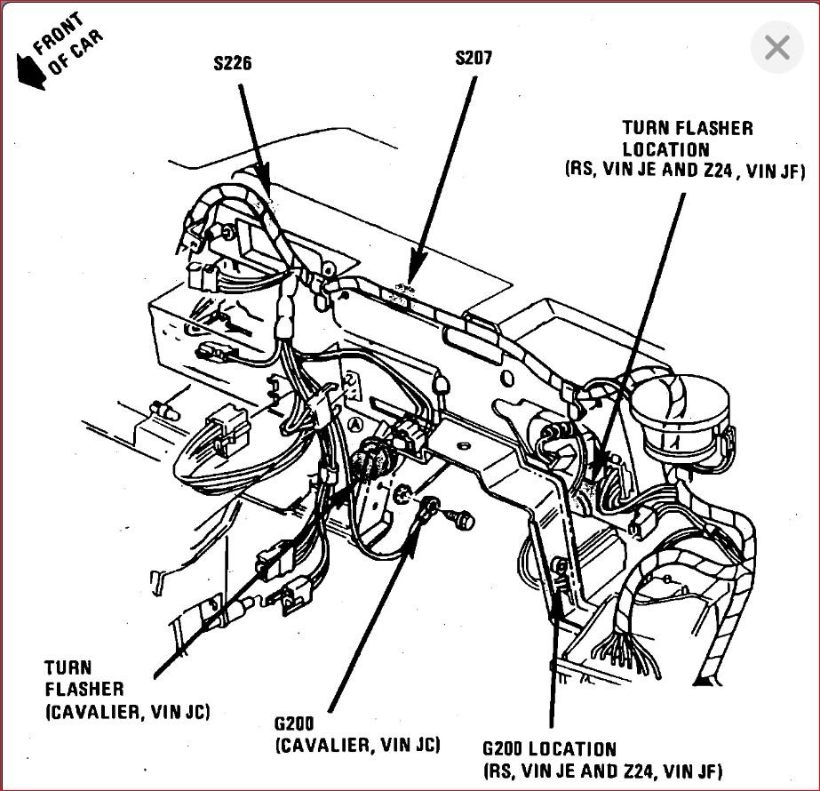

Hi, I have the vehicle listed above (wagon). I was curious as to where the flasher relay is located?
Jun 6, 2019 at 1:49 AM

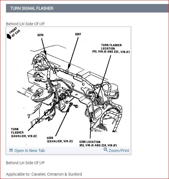

Hi Wagonbro,
Attached are the diagrams of the flasher location. Please let me know if you need more information. Thanks

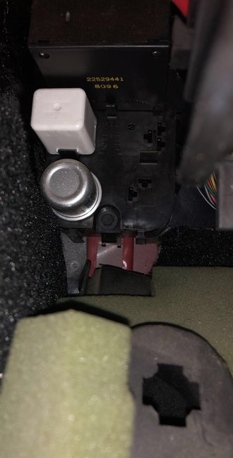

I was curious as to if this is the relay for the turn signals and if that is the hazard signal above it?
Jun 6, 2019 at 11:47 AM
That looks like a flasher relay so I would think it is. What location is this on the vehicle? It is hard to tell where it is.
Jun 6, 2019 at 12:35 PM
WAGONBRO33
  • 24 POSTS
That is on the driver side of the car to the far left of the steering column. It looks like a relay and it has the two prongs that older GM vehicles use so I thought it might be it but I wanted to double check just in case. :)
Jun 6, 2019 at 2:06 PM
I think you got it. The drawing location that I provided is a little hard to place because it is looking from the front of the vehicle which would place the location on the driver side, just about the area of the picture you took. Please let me know if you need anything else. Thanks
