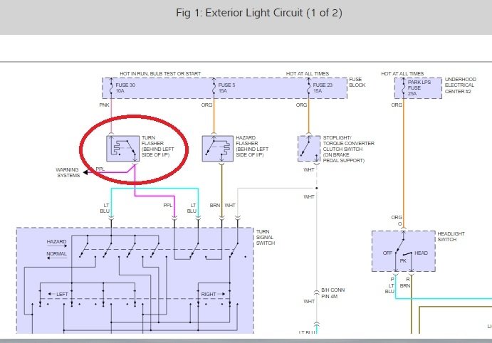

My blinkers come on but I have to click them myself. Where is the flasher located so I can change it?

Miss Susan,
I looked up a wire diagram for your vehicle in "Prodemand"
Part of it is posted below.
It states that it is behind the left side of the instrument panel.
