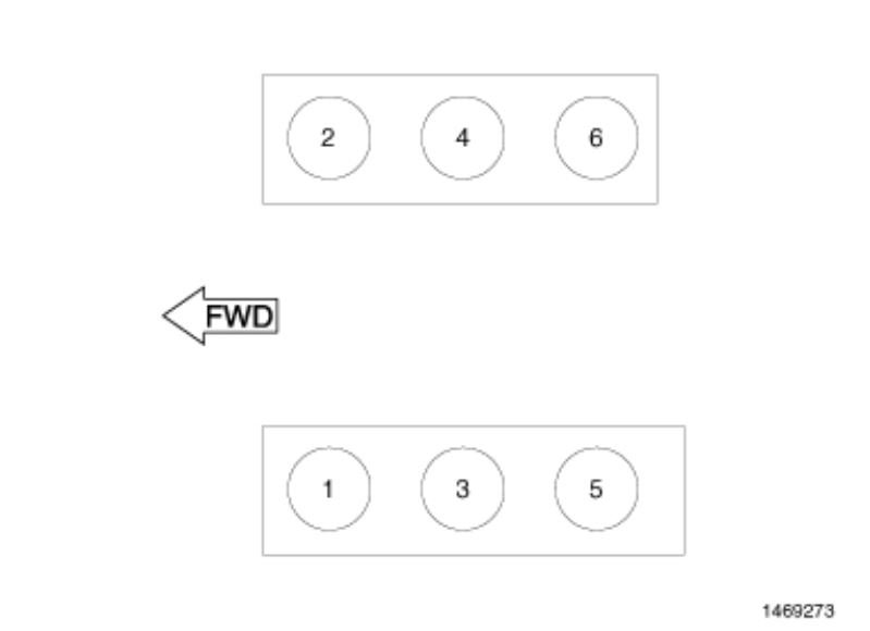

Firing order/coil order
JOSE GARCIA2
  • 2010 DODGE RAM
  • 3.7L
  • 6 CYL
  • 2WD
  • 150,000 MILES
Looking for the coil order/diagram for this truck. Took the motor apart now I need this order. Please and thank you!
Wednesday, February 12th, 2020 AT 11:51 AM
22 Replies
Good afternoon,
I attached the firing order and the cylinder location for you. Check out the diagrams (Below). Please let us know if you need anything else to get the problem fixed.

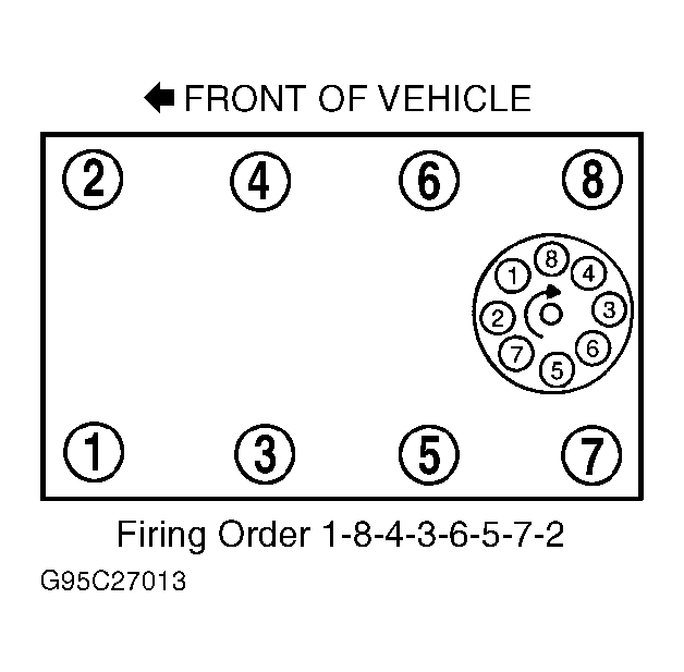

DXHHH6
  • 2001 DODGE RAM
V8 four wheel drive manual 74,000 miles.
Does anybody know the firing order for my truck listed above it is a 1500 pickup, or know where I can find a diagram? I have tried a couple of different ways which people have told me how to do.
+2
Friday, September 11th, 2020 AT 1:47 PM (Merged)
  • 75,992 POSTS
There you go and have a nice day.
https://www.2carpros.com/forum/automotive_pictures/12900_fo_50.jpg

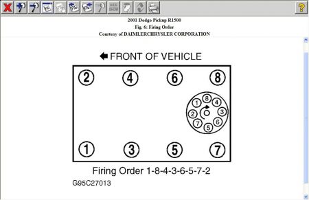

PAUL4277
  • 2001 DODGE RAM
  • V8
  • 2WD
  • 114,000 MILES
I am unable to find the firing order for my Dodge Ram 1500 V8. I know the wires were routed wrong, but don't have the correct order. Also, please verify the orientation of the order when looking from the front.
Thanks!
+1
MOPARTECH9423
  • 25 POSTS
The firing order for the 5.2L and 5.9L is stampped on the intake maninfold. Its on the top of the manifold. The distributor rotation is also stampped on the intake just in front of the distributor cap.
+2
Friday, September 11th, 2020 AT 1:48 PM (Merged)
PAUL4277
Thanks a ton! Funny. When they are correct, it runs like a champ.

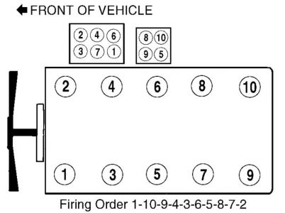

JOE_MACKAY
  • 1999 DODGE RAM
  • V12
  • 4WD
  • MANUAL
  • 90,000 MILES

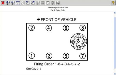

I Cant figure out which plug wires go to whitch plug. The new wires I got aren't the same size as the stock ones and the stock ones have different numbers on them than the new ones. What plug wire goes to what Plug. I have 8mm wires. My truck is a 99 dodge Ram 2500 488 V10
  • 75,992 POSTS
Check out the diagrams (Below). Please let us know if you need anything else to get the problem fixed. The 8 cylinder diagrams is in the next post down.
https://www.2carpros.com/forum/automotive_pictures/12900_sp_4.jpg
+2

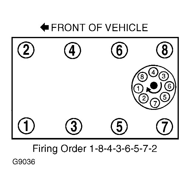

MCOLLETTE1
  • 1999 DODGE RAM
  • V8
  • 4WD
  • 120,000 MILES
I've read the code on my 318, showing a misfire on #4 cylinder. Trying to figure out how they are numbered, and will plugs and/or wires fix the problem.
-1
  • 75,992 POSTS
Check the no. 4 sparkplug/compression/injector
Misfires can be caused by worn or fouled spark plugs, a weak spark (weak coil, bad spark plug wire), loss of compression, vacuum leaks, anything that causes an unusually lean fuel mixture (lean misfire), an EGR valve that is stuck open, dirty fuel injectors, low fuel pressure, or even bad fuel
https://www.2carpros.com/forum/automotive_pictures/12900_fo_53.jpg

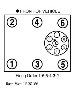

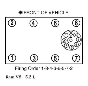

TER29
  • 1997 DODGE RAM
Engine Mechanical problem
1997 Dodge Ram Two Wheel Drive Automatic 100, 00 miles
360CI
BMRFIXIT
  • 19,053 POSTS
https://www.2carpros.com/forum/automotive_pictures/99387_Ram_Van_1500_V6_1.jpg
V8 5.2L & 5.9L
https://www.2carpros.com/forum/automotive_pictures/99387_Ram_V8___52_L_1.jpg
+8

Firing order for a 318 dodge engine?
DOCFIXIT
  • 18,828 POSTS
Here is the engine spark plug firing order. Check out the diagrams (Below).
Cheers
+10

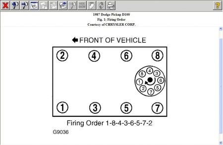

PAASTORMICHAEL_365
  • 1987 DODGE RAM
Electrical problem
1987 Dodge Ram V8 Two Wheel Drive Automatic
What is the spark plug firing order for 1987 Dodge van-5.9L? Where is no. 1 on cap?
Friday, September 11th, 2020 AT 1:49 PM (Merged)
  • 75,992 POSTS
Here you go
https://www.2carpros.com/forum/automotive_pictures/12900_dodge_fo_2.jpg
