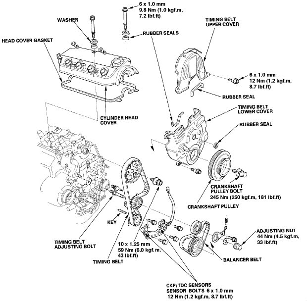

Not getting fire from brand new crank shaft sensor to the distributor or injectors. Both were working fine before new crank shaft install. Car cranks but will not start. Brand new fuel pump with filter, new spark plugs, wires good, and brand new timing solenoid. Battery, alternator and starter good including all good fuses. Lost!

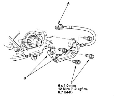

Hi and thanks for using 2CarPros.com. First, since you had things apart, I have attached pictures of the assembly for you to double check and make sure everything is correct. Here are directions specific to your vehicle for sensor replacement:
Remove the balancer belt.
Remove the balancer belt drive pulley.
Disconnect the CKP/TDC sensors connector (A), then remove the CKP/TDC sensors (B).
Install the CKP/TDC sensors in reverse order of removal.
Install the balancer belt.
Check these things first. If everything is correct, then get a live scanner and check to see if there is a signal from the sensor.
Let me know what you find.
