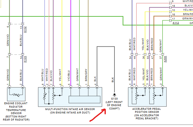

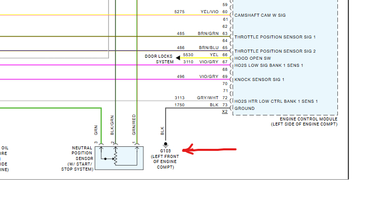

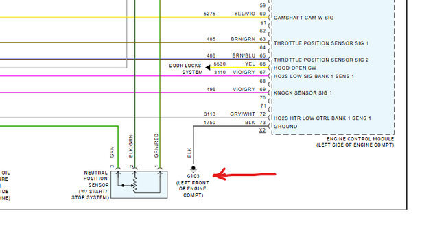

Yep, the first thing I would check is the main engine wiring harness grounds to the engine, it sounds like one of them is off. If the grounds are all good, clear the codes and then turn the key on and without cranking the engine over run the codes again these will be the main hard codes we start with. Here are the ground locations so you can check them out. Check out the images (below). Let us know how it goes

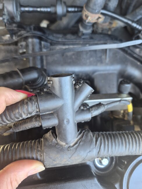

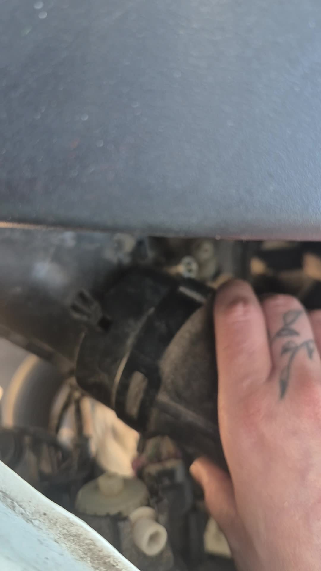

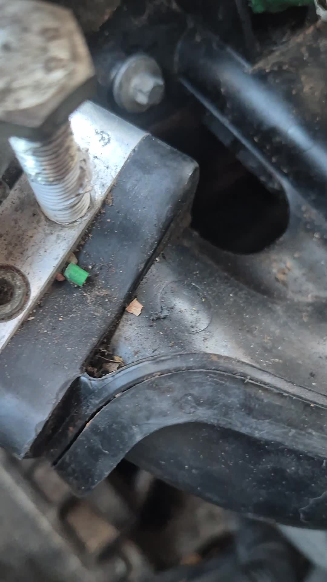

Complication happened i blew a coolant line. Water outlet where the pin is coolant is pouring out. So can't start the car until I get that installed. But I have replaced air fuel ratio sensor, valve cover, cleaned the MAF sensor, attempted to test the MAP sensor but can't make connection to test. Replaced all spark plugs, and did a ohms reading on the injectors and all readings are within normal good range. And I did the blow test on the purge valve which seemed good. However im attaching some photos and wondering if this is missing a connection of any kind and does the intake look normal? And i noticed there is a missing clamp on the air intake that attached to the airbox.

Yep, I don't like after market fuel injectors and testing them using the ohms is only one side of the injector, mechanically then can be bad and not spray correctly. Don't worry about the intake tube to the air filter that will not cause a problem. Here is a guide if you want to test the mechanical side of the injector.
